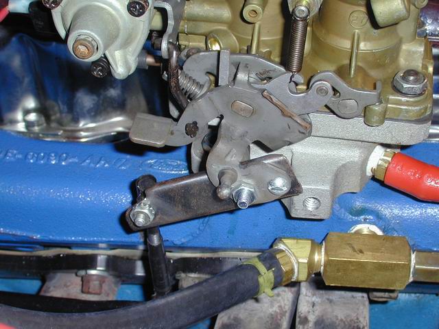

I bought another Holley 2bbl carb. It is a rebuilt unit. It has a different throttle mechanism than the old Holley 2bbl that was installed. With the old carb. I had used two pieces of aluminum flatstock to fabricate an accelerator connection to the carb. That did not work very well. The best solution I see for my current problem is a cable throttle.

You will probably have to re-route your heater hose, as the adapter will not accept a heater hose. I got a new hose from NAPA and ran it along the passenger side shock tower and right into the heater core. You will have to drain your radiator when changing the hoses so you might need more antifreeze if you do not reuse the stuff you drain.
If you are lucky, the accelerator adapter will be as easy as this:
I bent a new fuel line because the the fuel inlet on the carb. is pointing towards the firewall.
