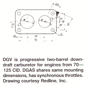

Holley/Weber 5200/ Weber DGAS/DGV. 4 stud Base size 47mm x 93mm, or 1.850" x 3.661"

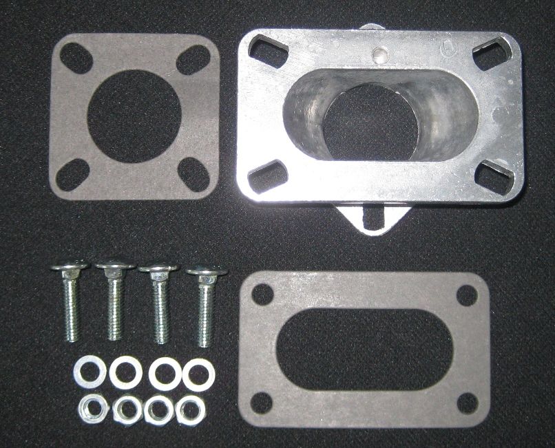

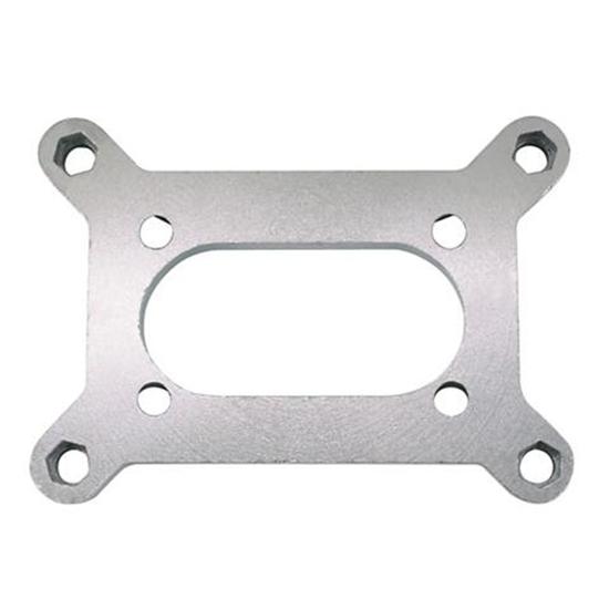

This one fits all three
This one shows the Ford 2100 and Ford 2150 series/ Holley 2-bbl 350/500 cfm 2300 series on the outside, and the little 2G "2Jet" platform size on the inside.
