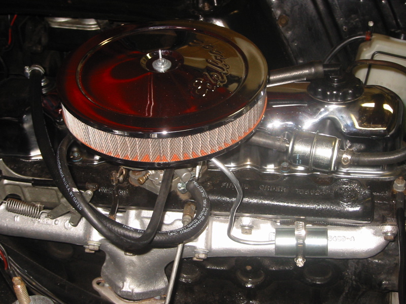

This worked for me when I had my 1 barrel 1940 carb:
No drilling required.

All you need to do is to get the open end of the choke tube near a source of heat, like Marc's.

Putting the tube on top of the exhaust manifold and shrouding it, like Marc's solution, might be an improvement in intake air cleanliness, over the stock hole exiting out the bottom of the exhaust manifold. Ideally, it would be best to provide a filtered air source to the hot air tube intake.
You might also cover the tube for two reason- to insulate and retain heat better, and to keep from accidently burning yourself from touching the tube. Many OEM applications have a woven material, tubing that slips over the hot air tube.
Adios, David
I used the tube and collector like Mark has; it came with a heatproof fabric jacket. I got it at a speed shop. Some guys use a length of 1/4" soft copper or aluminum tubing and wind it around the manifold for a 3 or 4 turns.
Taking Bhodi David's remarks one step further, you might get an extra long tube, do the winding and leave a length sticking out so you can clamp some sort of filter ball on the end, away from the heat source.
