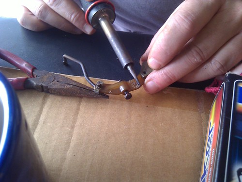

Looking good, but I have to ask.. what's up with the soldering iron?

Check the final assembly. He is relieving a spot where it drags in the fitting - I think.
The Piece actually snapped during disassembly so just plastic welded it back together
I am going to try to 3d print that piece and go from there...
Any suggestions??
shut the front door! You have access to a 3d printer? Do you need things to print? I could send you a list!
You know I have more carbs, I could send you another arm.
ahahh yeah its at TXRX its the Houston Hackerspace its awesome they've got some small ones
its works for now thanks though!!

Funny thing about what I said yesterday, the offer for another arm. I have 5 other Autolite 1100's at home and not a single one has the dashpot on the front like the one I sent you. Crazy! So the dashpot on the front (same side as the SCV) is for automatic transmissions and the ones that only have a single dashpot are for manual transmissions.
