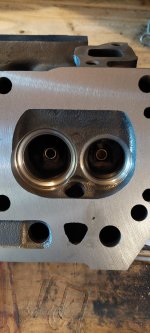

Alright so my buddy and I got the new bronze guides put in and reamed, new intake valves cut 45°, 30°, and 15°, exhaust seats all got a 4 angle valve job (75°, 45°, 30°, 15°), and did some porting cleanup around the valve guide boss. The head is at the machine shop to install hardened intake valve seats and deck .050" to approx bring me to 46cc head (9.4 SCR and 7.99 DCR). The shop is going to rough cut the intake seats and my buddy and I are going to do the 4 angle to the intake as well. This thing should breathe half decent for what it is and not leak now lol. 20220513_132216.jpg

Good job on finding the problem.

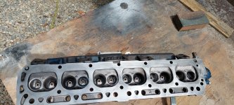

So interesting news, while having the head milled, there was a porous spot between #1 and the pushrod holes. Will have pics later. Instead of the .050" I wanted, he got to .036" before the hole. There's now a pencil lead size hole going into the water jacket. I'll need to JB weld it from the water jacket side. He stopped so it's no larger, but now my compression isn't going to be as great. Anyone have a part number for the thinnest head gasket we got? The felpro I've had is a .050", I'd at least want to get near the .040" mark.

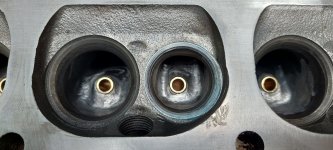

If you look closely between the chamber and the push rod hole, you'll see the pinhole. Would it be a bad idea to possibly fill the surrounding area with epoxy? There are plenty of other places for coolent to flow, plus its at the front so its closest to the water pump, but also the last part of travel for the hot coolent. Should this be drilled first to relieve stress then filled?

I think it would be better to weld it up too, I don't really trust the Epoxy to be a permeant repair anywhere there is much heat. Or you could just use a crack repair pin if there is still enough material so that you could drill and tap it, they look like this.
Being an air bubble hole, I do not think there will be much cracking is going on, but you can see better what is going on. How does it match up with the gasket, outside of the fire ring, does good gasket material line up there? How is that hole any different from the triangle water port, that port is sealed by the gasket, why not this hole?
Just make sure that you do not make it worse, If it looks like the gasket will seal it I would try JB but do not block water flow. May be a smear dab of the best RTV or that Hylomar on it when you install the gasket.
So it seems I got it running. We ended up JB welding the hole. The cast iron plug wouldn't have worked and epoxy was looking at being the best method. Not 100% sure if the leak is fixed howerver. I got a Holley 2300 350cfm Street Avenger and it seems to want 64 jets so far to cruise properly (AFR high 14s low 15s), but my WOT is like 11. Are my jets looking too big, indicating a vacuum leak, or do they look right? How do I fix the WOT running so rich? Do I need a different metering block or some other tricks?
