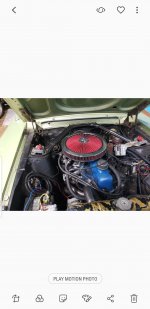

Just thought I would post an up date. The Alumn head is still on hold as I have been trying to make sure the 2300 Sniper is operating ok, as I've had some issues with exhaust leaks . The Sniper absolutley will not operate correct with any exhaust leaks before or with in about 18" after the O2 sensor, all though I can unplug the o2 sensor & put it in open loop & it works semi ok.
I've ran it on a Couple of short trips since the repairs & it has worked perfect. A few more trips & i will install the Holley Hyper Spark dist for sniper controlled timeing , i don't want to add a potential problem until I'm sure the other is solved.
Got all the parts here but the intake & it's still in the trunk of my vert where it's been since I purchased the head setup. Just so you know my 200 runs pretty sporty now with the Sniper & header on a stock small log head on a stock motor. The v8 mustang guys say we are nuts to spend the money these parts cost, but they spend the same kind of money for these kind of parts with the only difference being they get more power. To me that's kind of crazy because they had more power to start with.
One side note some of the 2300 Sniper people might be intrested in . I've been doing a lot of checking on the Sniper facebook page & an interesting post I came across is a possible issue with air flow into the Sniper when useing a drop base air cleaner for clearance issues. Since I do use a 1" drop base & a 2" filter to get hood clearance I purchased a new air cleaner so I can use the lid that is a filter. I put this on when I fixed my exhaust leaks so I can't say for sure if it made any difference. All I know is she sure is likeing everything now.

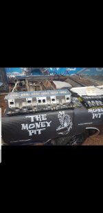

Man after looking back thru these post I have to say I sound like a broken record about the head install . But it's not been all wasted time ,I've been following the eng install in Goldie. Their saga has been a learning experience for me .
After the initall woo hoo wore off I have been steadley getting parts together . I don't know weather to go for it or hold up untill my knee gets whatever did to it .

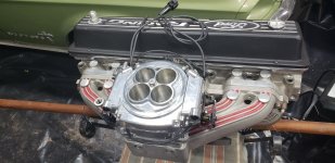

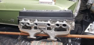

Looks great. Love the split manifold. I ordered that valve covers from Jose also. He didn't have enough from this run. Have to wait.
Keep posting pics as you go. Are you going to coat the intake with anything? It gets annoying trying to keep it clean. How about the exhaust from Aussiespeed? Keeping it bare or coating it?
I have been thinking about clearcoating the head & intake . The Aussie speed manifold I would like to put something on it but have'nt found anything that really held up on my other stuff .
Right now I'm running a split header with 2 1/4" duals . I purchased the dual outlet cast iron header thinking maybe a turbo on down the road.
I noticed you said it was hard to keep the intake clean,are you running one of the alumn heads? If so what type carb are you running ? You have any issues getting everything up & going ?
When I got the valve cover in ( it was a little over a month from when I got in with Jose ,so don't give up ) I though pretty cool . Later when I was putting the parts together to take the pictures I realized that cover is as heavy as that cast iron manifold maybe a little heavier .
Right now I'm still up in the air as far as which way to go with all the parts, put them on my 200 or go all out & put them on my 250 & put it in the car .
It's been a long road to get to this point with getting everything together .
