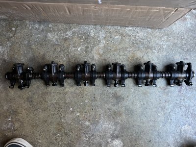

I finally got around to taking a photo, and I’ve attached it for you. There are some signs of wear, but I think it should still be okay, right? I mean, the part is 60 years old.

It looks like it is adjustable rockers. If the adjusters don’t seem tight in the threads, they can be replaced. There should be even resistance when turning- no loose spots
Hey Don,
Thanks for the info! I’ll check it the next time I’m in the workshop. Unfortunately, it will take a few more days because I’m currently sick, but I’ll keep you updated.

anyway in the pic you can see some pitting where the valves contact, it might be best left alone rather than to polish and remove the hardness. what we see there is likely quite typical for an older engine. Id just take it ointo account that if there is an impression , the feeler guage is affected.
now the pros her may know a lot more but I believe this can lead to one setting the valves too loose, that may mean they dont open as far or when they close the dwell time of them being closed is increased. I think if you go too far the other way and set them too tight then you are reducing the dwell time that they are closed. the heat on the valves transfers when they are closed so a shorter close time might lead to exhaust valves burning.. I think if they are a bit too loose it might tick a bit more. from what Ive been told it is probably better to have them on the loose side and closed longer than to burn valves..
I think the impression would possibly cause one to set them a bit on the loose side due to the depression.

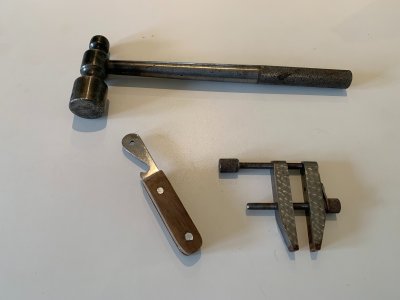

Anyway, your mention of bottle openers reminded me that I inherited the bottle opener I made my dad in grade 8 as well as that ball peen hammer and a clamp I made him in grade 9. I excelled in metal work and electronics and by Grade 10 I had free reign and I was designing and building steam engines. That ball peen hammer had a lot of use. He built a couple of cars in our garage (ground up, full builds, mechanics and bodywork).
Photo I took a moment ago of the only things I think I have from around 1978-79.
