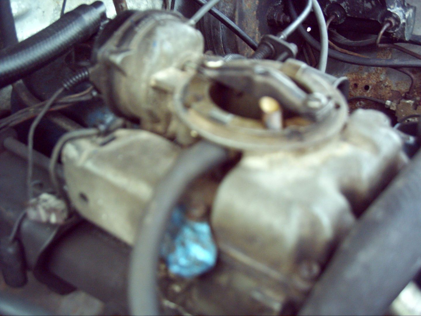

If you buy a rebuild kit, they usually have that pic i attached printed out for you on a big sheet of paper, still might want to take photos of the stages of carb disassembly while you are doing it, however.  Here is a picture i took from when i did mine.

			Before changing jets I would try the metering rod adjustment. It has always fixed any YF mixture issues I've seen. The screw in the background raises and lowers the tapered rod in the jet. Raising it will fatten up the part throttle mixture without fattening up the WOT mixture, which I suspect is not too lean anyway. Plug readings at WOT mnust be taken after running the engine at WOT and not letting it come back down to idle while running or the WOT reading will be affected.
Modern plugs will tolerate a leaner mixture and may look white, even though the mixture is correct. This is especially noticeable on fuel injected engines.
