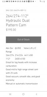

Vintage Inlines has the exact cam i want for my build but they're out of stock. I've contacted schneider but they're out too and said call back in a couple of weeks. Its the only thing holding me back from starting the bottom end. Even with all the new internal parts and DUI distributor along with the headers and the larger intake /exhaust valves....I'm not sure my horsepower will be that significant. It's really hard to just see what I have and put a number to the horsepower I will achieve but I welcome ALL guesses. I initially was hoping to get 200 HP out of the 200ci straight six. Last item will be the Weber 32/36 carb kit with the straight bolt on feature. If I can squeeze even 150 horsepower I'd be happy considering the parts I have weren't really that expensive, minus the DUI of course...I don't think I'll be running it over 5k rpms that often but I would like to keep up with highway traffic.The Clay Smith 264/274 cam is very close to the same as the Schneider 270-280H cam.
Either of those cams are fairly big for a 200 six if you are looking for a smooth idle and low rpm performance.
What rpm range do you want for a power band?
