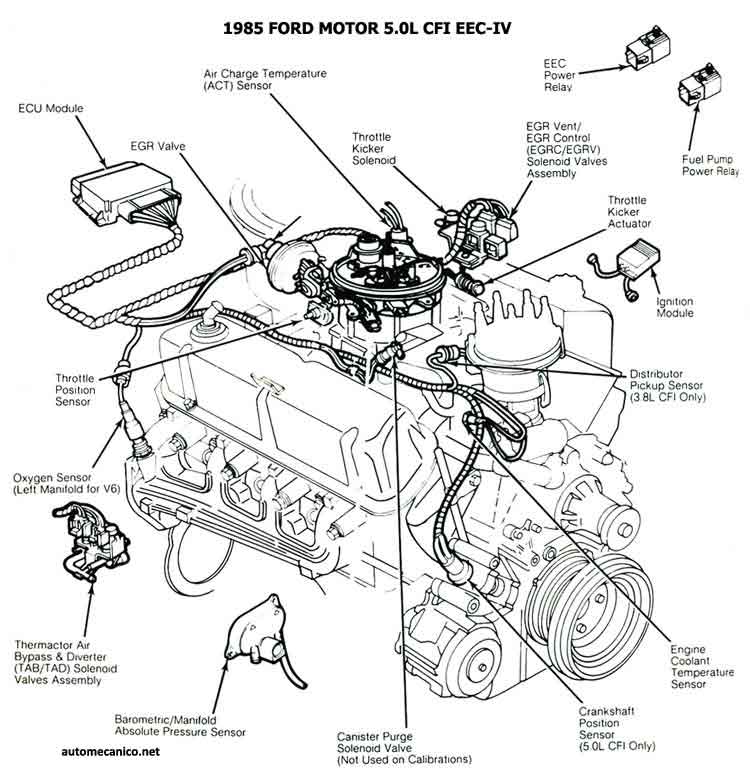

			Even before EEC-III was released into the wild, Ford was already developing EEC-IV to meet the new Onboard Diagnostic (OBD) rules coming down the road.
EEC-IV is the most prolific of Ford’s engine computers. In one variety or another, it was found on every Ford vehicle starting in 1984. It would not be phased out of Ford’s inventory until the late 1990s. Using an Intel 8061 processor with a memory chip that could store 1 kb of ROM and 128 kb of RAM (late 2 8 kb ROM and 128 kb RAM chips were used), the EEC-IV could control nearly every aspect of the engine. In 1986, Ford introduced sequential fuel injection which would allow precise metering of fuel to each cylinder. The EEC-IV could do that. OBD-I was required, and the EEC-IV could do that. Also, thanks to a long run and some computer savvy gearheads, the EEC-IV was cracked and many homebrew systems designed to allow people to upload their own calibration to the EEC-IV. The EEC-IV was even used on Formula 1 cars, one of the earliest digital control systems for F1.
TFI down graded the traditional DS1, 11 AND 111 reluctor to a low RF trigger, and then added a PIP and SPOUT system to condition the square wave form needed to run a pure digital system.
Although all the other on line experts rabbit on about how a Crank Position sensors is for port injection and sequential injection, that's note true. Only Ford would use a Crank postion sensor to allow a Throttle Body Injection or even just an electronic feedback 2-bbl 2150 Motor Craft or Variable Venturi 2700 or 7200 2-bbl Carb to operate.
