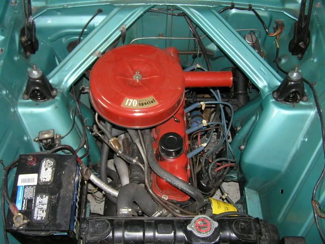

I don't recall there being a baffle. Looking closely at this pic of my 170, the draft tube and breather cap are both located toward the leading edge of the engine... so I suppose a thorough PCV conversion would require inserting a baffle and accommodating the PCV valve at the rear of the valve cover. Excellent points!

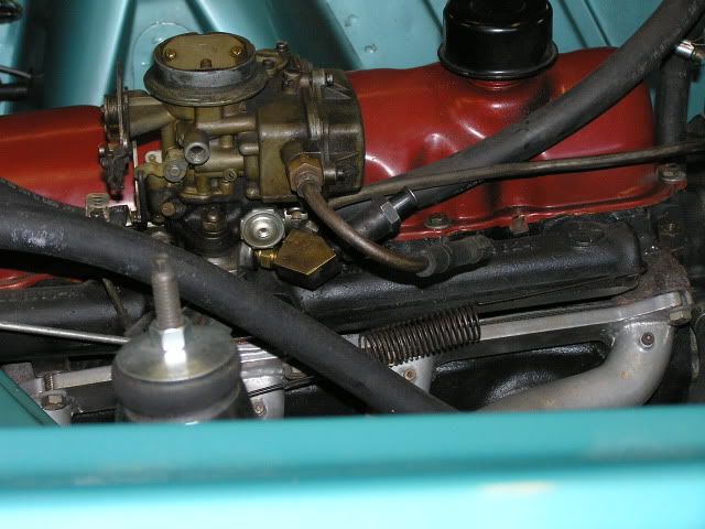

My '61 Falcon w/ 170 was a CA built and sold vehicle. As such it had the original PCV system as required for CA while the rest of the country still had road draft tubes.

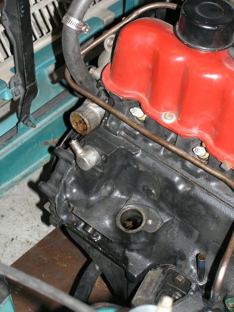

A picture of the fitting that is pressed into the road draft port. http://i290.photobucket.com/albums/ll27 ... market.jpg
Base of the carb there is a brass (manifold) fitting screwed into the carb adapter plate. Screwed into this fitting is the PCV valve.The fitting also has a port for the vacuum line to the vac pump that is part of the fuel pump (to boost the wiper operation). All of these parts are the as manufactured and delivered by Ford for the CA market parts that were installed on my car.

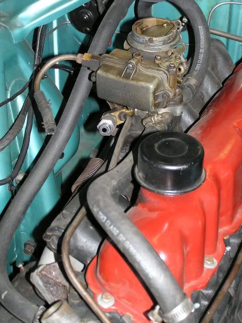

Looking into the end view of the PCV valve. Note the valve is a machined part. To clean it one can remove the valve and unscrew the two halves of the vlave body
http://i290.photobucket.com/albums/ll27 ... 240009.jpg
Assembled view of PCV tube (about 1/2 or 5/8 inch diameter). Tube has a shrot length of hose on each end.

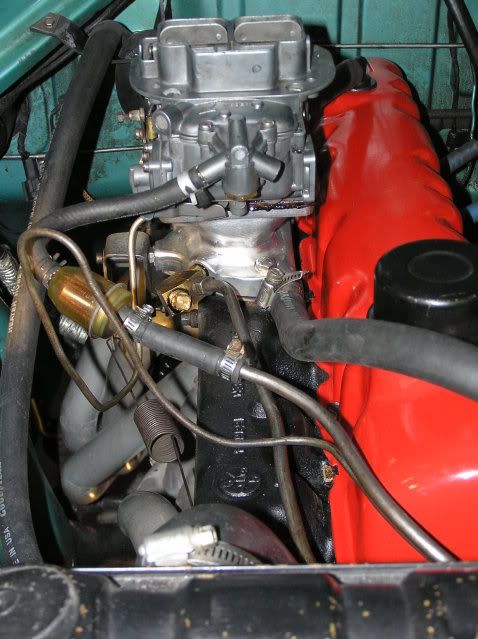

Finally a current photo w/ my Weber 32/36 DGV. I made a custom adapter with a second PVC port to the rear (I currently have a '78 200 so I have to use the valve cover PVC port and the original port in the brass manifold is blocked off. Someday I intend to go back to the '66 200 so that I can once again use the stock valve cover and stock PCV port in the block.

I love the pic of the draft tube fitting at the block! Now to find one...
