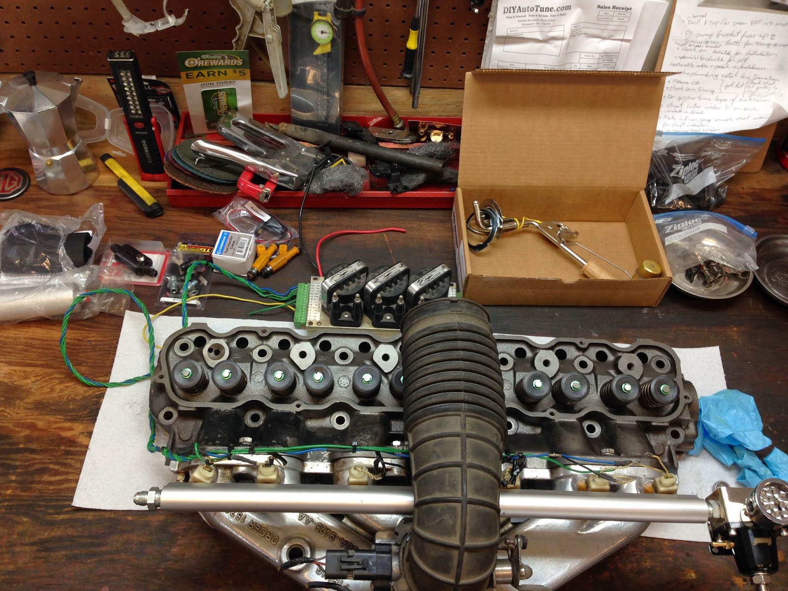

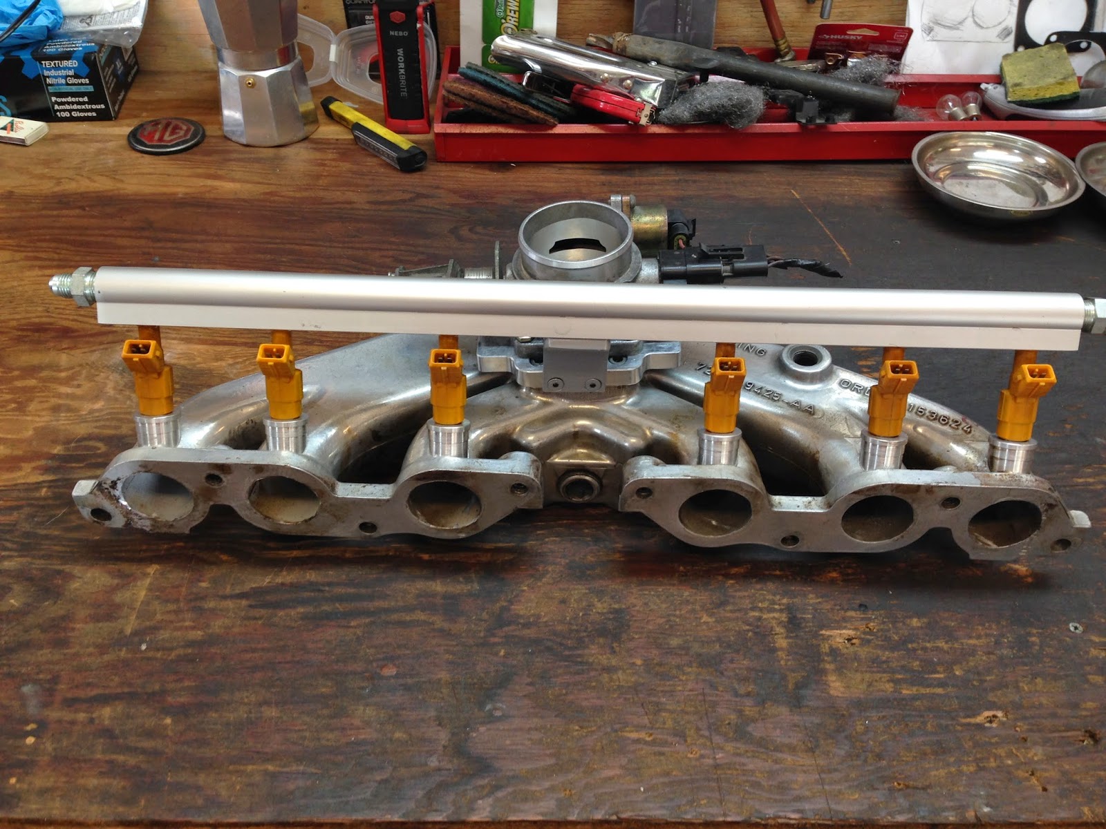

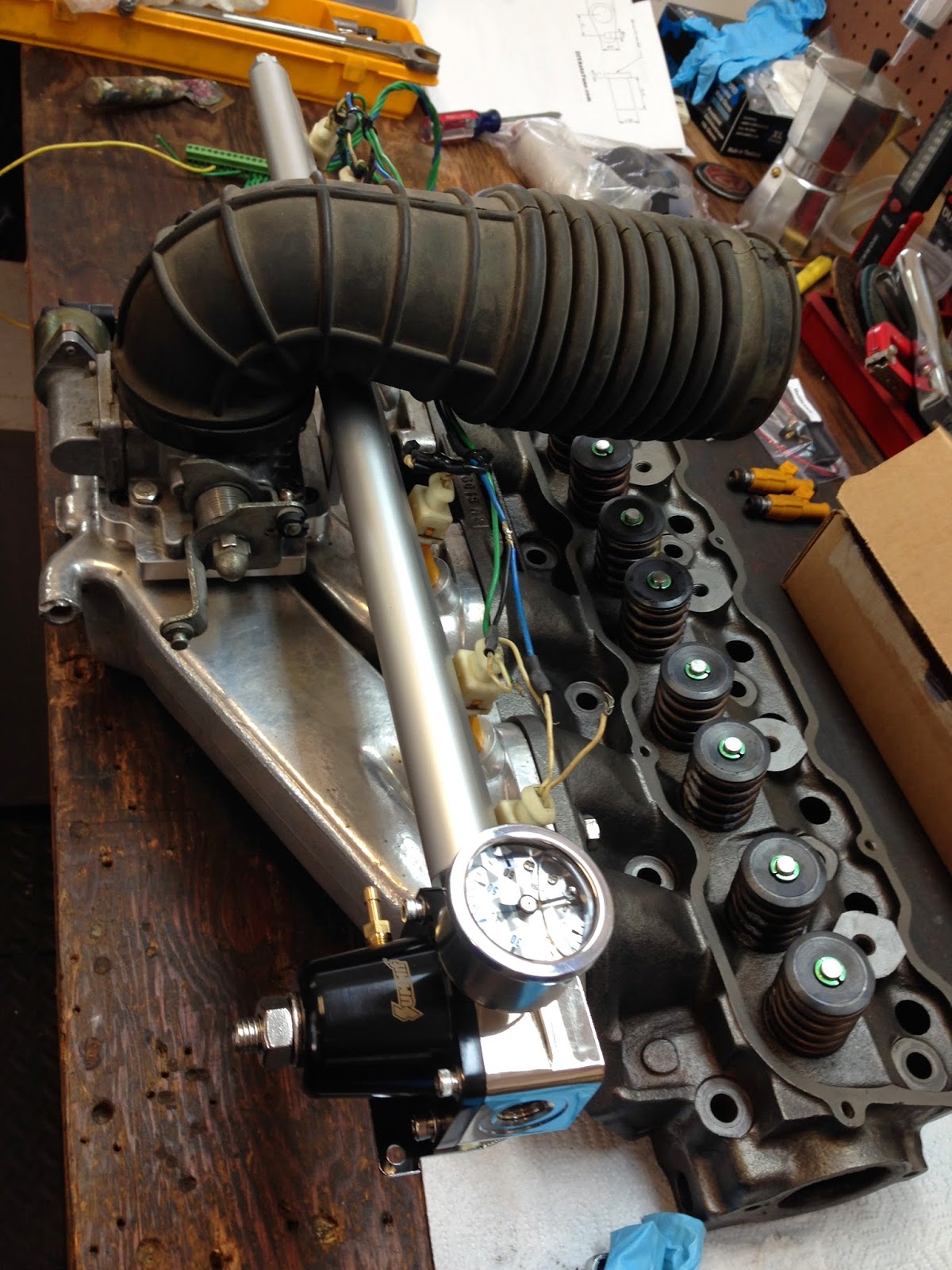

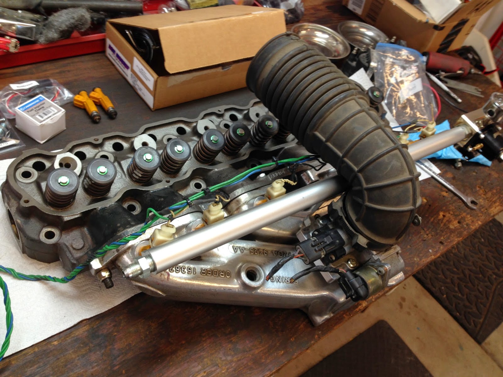

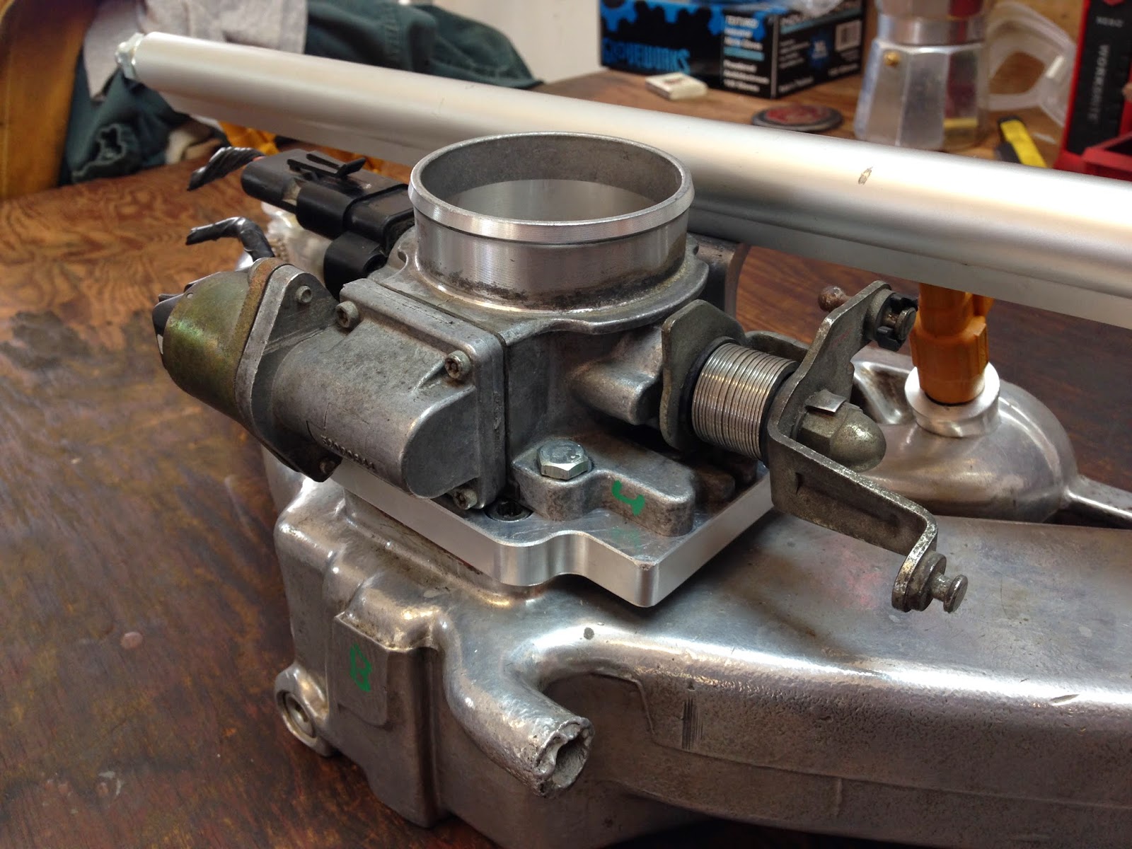

Method 1. You can use a Transco 2-bbl to 1-bbl adapter, and run a 2-bbl EFI 4.9 throttle body on top, with just enough room for 6 injectors using

Method 2. Lincs200 and xflow Fairlane's combined. When
Lincs 200 came up with a Sidewinder external ducting to the out log like this,
I knew I could put a 2-bbl on the log and get it flowing well enough for port EFI. You can't direct mount it like the traditional direct mount Small Ford Six log because it gets in the way of the injectors. You can direct mount it the conventional V8 2-bbl way, and run a secondary manifold Lincs 200 style under the outside. Here's how I did mine.
