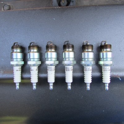

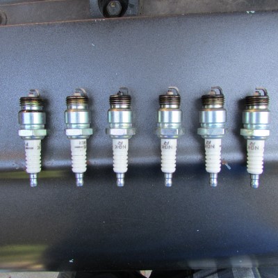

Anyway, I pulled the plugs yesterday to replace them with iridium plugs. More experimental than anything else - I figure these plugs do well on other cars with similar ignition systems, so I wanted to see what they do - if anything - on the Falcon.
The plugs than came out have around 1,500 miles on them. 500 of that was on the old ignition and they did NOT look pretty when I fired up the EDIS. Quite black from an obviously rich mixture. 1,000 miles with a modern ignition system actually cleaned them up quite a bit! There is some baked-on carbon, but otherwise they look quite healthy to me! They are NGK V-Power (copper/resistor) plugs.
Looks good. I dropped some cash on the iridium plugs and drove from DC to boulder last summer - 1,750 miles - and then a bit around town here in Boulder. Took the plugs out at around 2000 miles and they were starting to disintegrate. Not sure why, haven't had that problem with other plugs and the iridium plugs in my Infinity have 55,000 miles on them with no problems, but you should check them periodically to make sure they are doing well in your engine.
I will definitely pull them out periodically.
IME, some cars *really* don't like iridium plugs - my Saab would be a good example of that. I think it has more to do with the ignition system than anything, though. Now that you mention it, though, I could see how a mixture problem could also give them grief, since there isn't much electrode there. A rich mixture that fouls the plugs would probably have a pretty profound effect on the pointy iridiums.
In any case, it's something I plan to find out sooner rather than later as I intend to drive this car to Vegas in September. 1000 mile road trip in a '62 automatic Falcon? Surewhynot. What could possibly go wrong? :)
