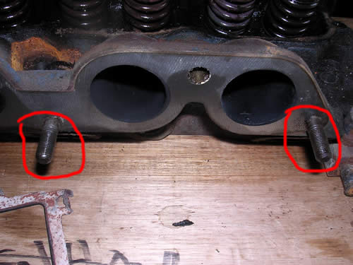

just getting ready to take the head(s) to be magnafluxed and hot tanked. i have 2 questions.
in the picture below, does this fitting come off and does it just screw out? i'm a bit worried about trying to get it out, don't want it to break off. will it be needed later when the head is installed on the engine?
when i took off the intake these 2 bolts would not come out. what is the best way to get them out without wrecking the thread or the bolt? and is it necassary to take 'em out before i take it in to the shop?
thank you!
The water fitting comes off, just wrench on it. If you destroy it by some chance you can get them anywhere. The same goes fo rthe studs.
