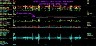

This is an '86 F-150 4.9 twin turbo I did for a client early in the pandemic, that used the Ultrastat kit with housing and Ultrastat thermostat. You can see the very stable temperature logged across the 28 minute log. You can see the hard accel/decel in the blue rpm/s trace at the bottom, so you know it wasn't just loafing along. I require boost conversions to have high-flow thermostats installed to help stabilize temperatures for effective tuning.
That said, the thermostats are made with all the same parts, in different diameters and ratings, so the functional guts in a Ford 300 thermostat are the same as one for a Buick - just a different housing to fit. The characteristics of a certain thermostat brand and model tend to be very similar from one application or engine to another, which is why I have seen many Motorcraft, MotoRad and others. Why would the 240 or 300 be a special case? Not being snarky - that's a sincere question.
Good knowing that other thermostats are stable. You logged it for 28 minutes. The thermostat that was used in the test held up well to abuse. This is what people need that stress their engine. Thanks for posting the info.
