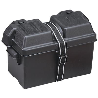

Just in time for the hoildays....
$42.95 @ Summit
Alex :wink:
