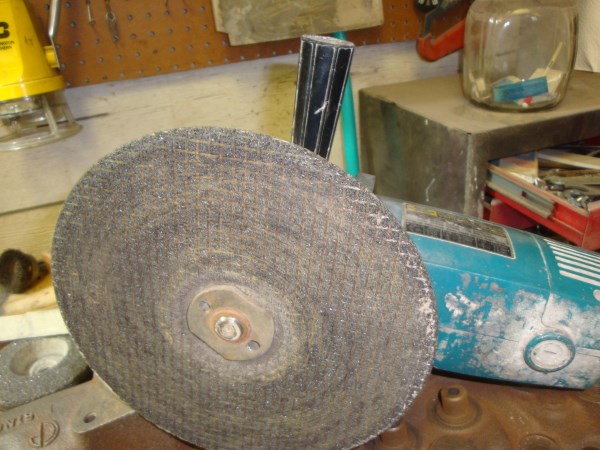

No fill is needed if it is layed out right ...The one in the above pic would be better if moved to the right some and away from the valve side some. There is no reason to fill it, is a waste of time. I speak from experience and have actually done these things.
Nice job for doing it without a mill.

I cut the Log on my 200 to accept a Weber 32/36
