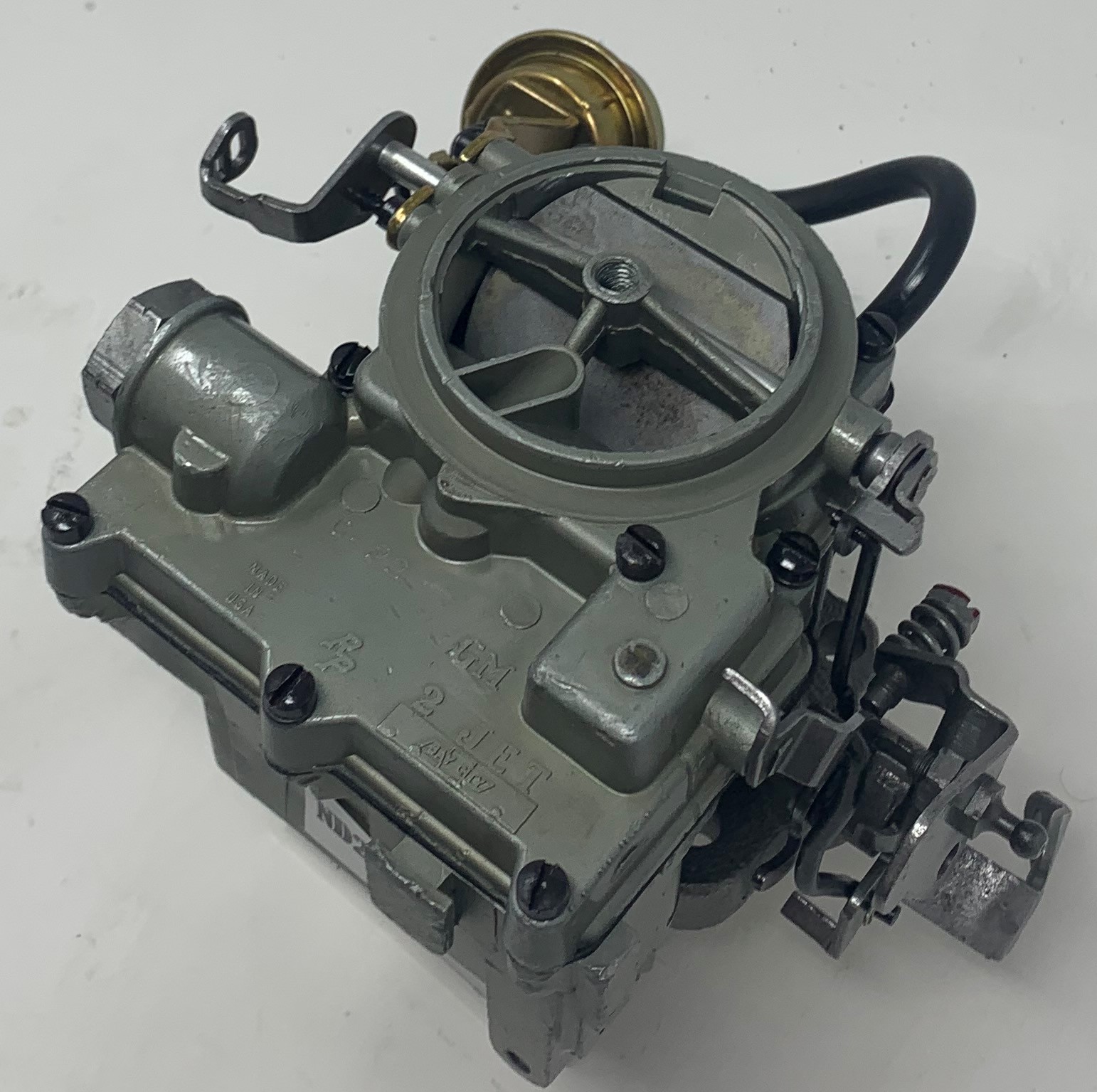

If this is actually in stock, this is what I'd get-
