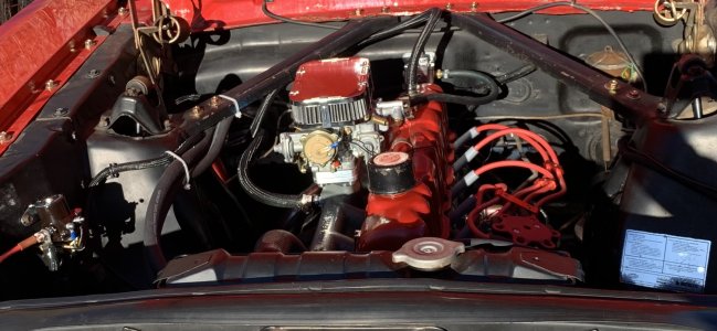

A word of caution: If you have the stock Autolite carb and distributor, you’ll need to replace the distributor because it will be a load-o-matic distributor which requires a specific vacuum signal from the carb. It’s not a huge deal because there are plenty of better distributors to choose from but it’s something to keep in mind.
Here’s my 66 Mustang with a Weber 38/38 and an HEI distributor and coil. Clifford Performance is who supplied my Weber carb. It’s a complete kit. The distributor I sourced from an EBay Store called SwapMeetParts but there are several sources for distributors.
