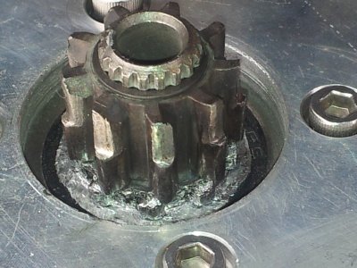

I bought a RobbMC starter for my 67 mustang with a 66 200/C4. It worked great. When I swapped to a T5 I had an extra tab welded on for the different bolt pattern without checking the needed pinion depth. You can see at rest there was still gear mesh, and on start the backing of the starter gear was pressing against the ring and is all chewed up. This was a me problem so I paid for the repair. I recall the information was vague on compatibility, because there can be a fair amount of difference from year to year, converter to converter, etc.
Mine needed more help than a gear replacement, you might be able to get yours repaired from a local shop? I have a couple starter repair shops in town here in California, not sure about your area.
FWIW, the mounting plate I needed for the T5 was the 302 plate, needed to weld another tab to it, but measured many times before doing it.
I really like my starter, it’s just a drag there isn’t a lot of accurate compatibility testing with our sixes.
