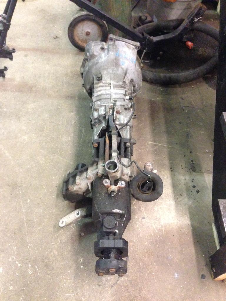

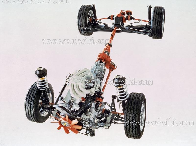

Mike 1157 used the later S54 ITB EFi intake from the M3 to fit to the 250 x flow six.
the Getrag 260 four wheel drive S54 engine 325Ix buildup post!
https://grassrootsmotorsports.com/f...-project-cars/325ix-s54-e30-swap/87203/page1/
You could grab any M20, M21 or S54, and make it fit your engine bay.
