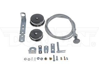

You can also buy this manual kit if thats how you want to go. Its from Dorman #55101. Most stores carry them under the HELP! name or under their own like Napa's balkamp line. One trick about going from auto to manual choke is for everything to work properly you need to step on the pedal and then pull the choke so it can get onto high idle. Other catch is these kits are designed for V engines so you have to get creative and come up with some of your own mounting on an inline.
Dorman also has all the other choke bits like the tube and even a box that you can clamp onto headers or the down pipe if yours is missing or damaged.
