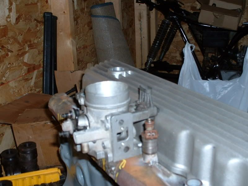

viewtopic.php?p=430533 In the instance of EFI-ing a little 200 log six, you add a custom new
lower part to the log, rather than a new custom
upper EFI part. You can use the stock 4.9 EFI upper as is. The Big Six has inlet 1 and Inlet 6 22.40 inches apart, while the Small six has differential pitching of the inlets, and inlet 1 and Inlet 6 on the log head are about 18.70 inches apart. So the outers need to be brought down to the log head spacings by about 1.85 inches (the difference 22.40-18.70, divided by two) each side on the outer inlets. Or you just do an Ak Miller
http://www.classicinlines.com/HA1.asp and add four pipes by braising, then perhaps two extra sidewinders to the outer welsh plugs on the log. The log intakes vary from 21.25 to 21.85" long, and a 22.4 inch spacing 4.9 EFI manifold would then fit with ease, each of the six pipes would then line up with the upper intake with the utmost simplicity.
A 50% drop in capacity from 300 cubes to 200 isn't a major,when you can control injector size and fuel pressure. SD EFI gets screwed up when the pulse timings are out of sequence, so you'll only have to run the stock 110 degree lob centers that the 240 and 300 268 degree cam did, and then fiddle with the fuel delivery pressure and/or injector sizes to suit.
