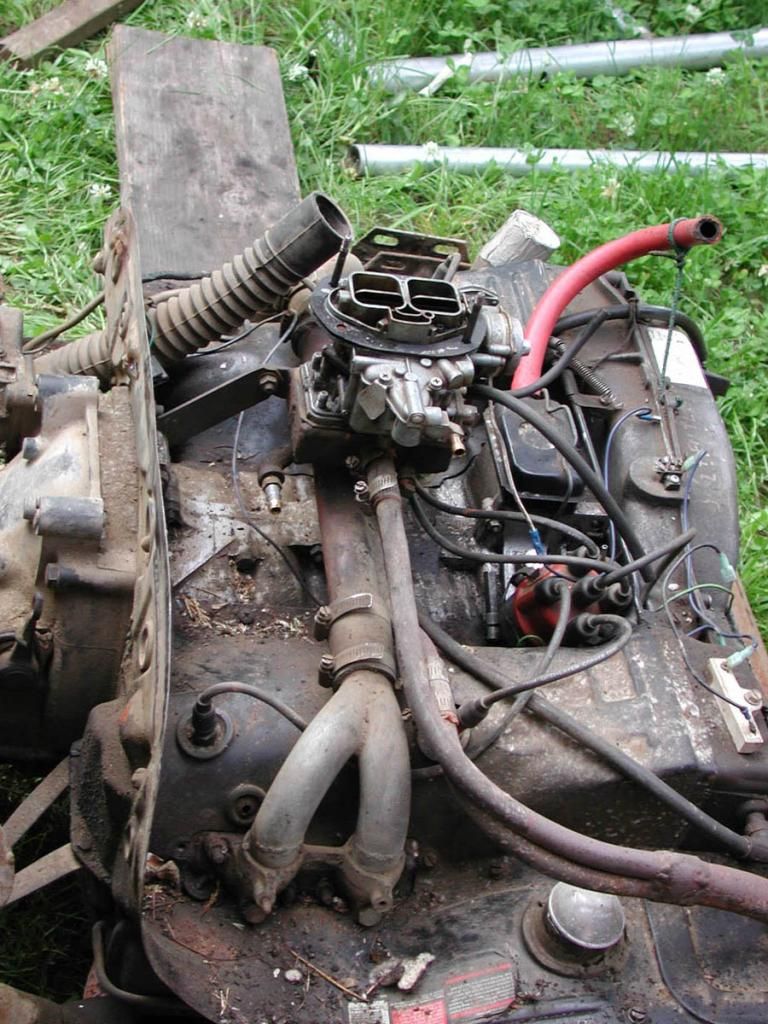

Here is just some of the Volkswagen 1-bbl Solex adapters for the yet another brace of 5200/5210/5220/6520 2-BBL carbs. Its designed for their log intake single porters, but basically using an adapter like this, your able to hook up to an early Tripower intake, and provide three duces with mechanical secondary's. You find them from old Redline cat no items.

This with a Datsun 1200 cc air cleaner
http://images.thesamba.com/vw/gallery/pix/287654.jpg

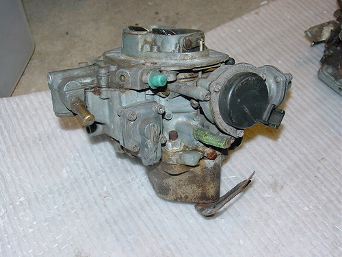

This looks very much like the rare 2V carb and adaptor Ford might have used on the 1980 Fox cars, but its actually a VW Beetle Solex 1-bbl verses Holley Weber 5200 2-bbl aftermarket kit.

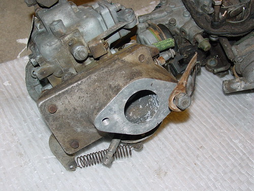

There is also the much smaller 22 mm venturi Holley 180 cfm 2-bbl carb, sold as the Motorcraft 5740/6740, or Carter Weber 740 series carb. It's just a Weber 32 DFT made under license for US Ford Escorts from 1981 till about 1988.

The confusion exists because the info on it is messed up. Its a Motorcraft carb, a Weber designed, but made in the USA carb for Motorcraft by Carter. It's stamped as a Carter Weber for Motorcaft, not a Holley Weber. It became a Carter Weber in 1983 model year, but before that it was made by Holley.
Problem is Holley's 180cfm carb is not cataloged as the 5740/6740 or "740" series carb, that's not its list number.
The 180 cfm carb is wrongly cataloged as a 5200 series 2-bbl carb
In fact, the 230/255/280 2-bbl are 5200/5210/5220/6500/6510/6520 series carburetors, and it is totally scrambled with the Holley part numbers and list numbers. On some literature the R 6536/List 6536 carb, the basic 1971 to 1972 Pinto 2000 carb, is listed as a 180/230 cfm carb.
They do all sorts of cracked up stuff to the cfm rating of it and its siblings due to changes to the basic carb.
To confuse it more, the 2210 Bug Spray is a 200 or 300 cfm Holley 2-bbl based on the last Ford V8 flat-head/side valve and Y block carbs
There is no 180 cfm 5200/5210/5220/6500/6510/6520 series carburetor.
