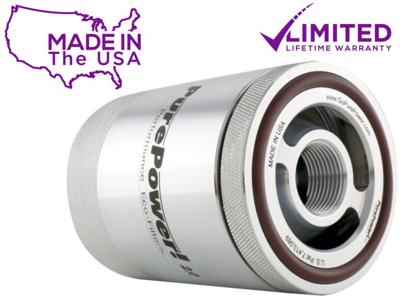

But for the last 10-15 years I have only used Pure Power on the Mustang. They are expensive but it is a lifetime filter.
