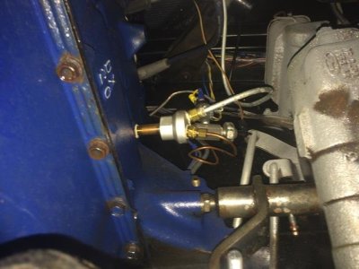

I read what I could find on setting up a turbo on a 200 but did not find where the oil feed is taken from. I assume the port for the oil pressure sender would be the spot
Yeh, just tee off the oil pressure outlet at the rear of the block. A small line is OK, as the turbo doesnt need much oil flow. I would use a flexible line that is heat resistant. Drain is important, it must go into the sump above the oil level and needs to be IMO no less than 13mm ID. You could go in through the fuel pump hole if your not using it. You must have a good crankcase breather arrangement so that the crankcase never has pressure, otherwise the turbo cant drain and oil will overflow into the compressor housing.

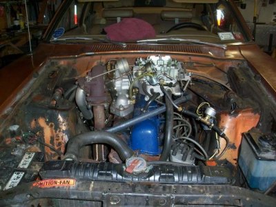

Turbo and/or Supercharger :

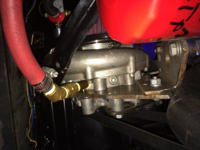

oil pressure sending unit block port on the Mav' 250 supercharger is busy with original 'idiot lite' unit, Oil pressure safety cutoff switch for elec. fuel pump , mechanical oil pressure gauge and the 1/4" oil feed line to the supercharger. ( with air line 3 way splitter )
setup uses 3/4" oil return hose to oil pan return port below block fuel pump boss. ( hi press./temp hydraulic hose )

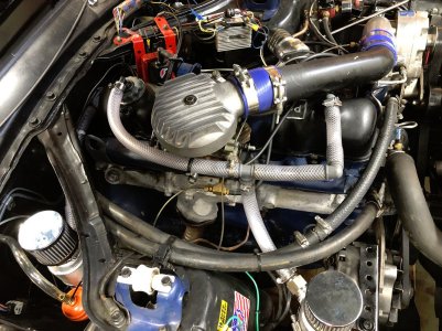

Crankcase pressure under boost is handled by a Fuel pump boss blockoff plate with large hose to oil separator/condensor/catch-can. Two large hoses from valve cover go to another can.

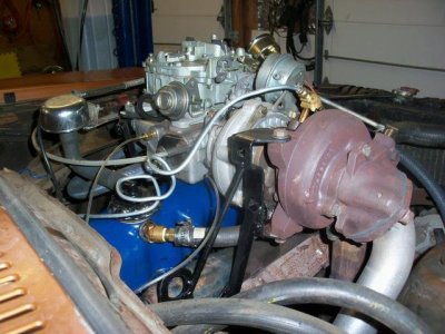

Previous turbo 250 had oil line from pressure sense port and return to Valve Cover.
have boosted fun
View attachment 29747 . View attachment 29751
View attachment 29750 . View attachment 29749
have boosted fun
Thats the same turbo setup I am trying to use
" Thats the same turbo setup I am trying to use "
hey A-Y, are you trying the draw-thru turbo like in the previous pics ?. That is simply the complete unique Quadrajet 4bbl carbureted DRAW-THROUGH Turbo setup from pre-fuel injection Buick 3.8 V6 .
haev fun
the motivation - ... like 90 to 168 RWHP at only 8 lbs boost at 3000 RPM !
