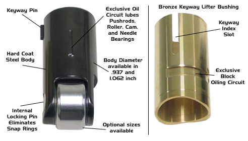

Now, back to the lifters, as I'm sure you are wondering how we plan to eliminate the tie bars. Jesel already produces the required lifters; they just never intended them to be used in an inline six application. That's not surprising is it? :lol:
The lifters have a tiny knob that sticks out the side of the lifter. They are available in two styles, with a rounded end or a square end. To install them in the block you need to do one of two things. Machine a grove in the lifer bore which uses the round end, or re-machine the lifter bore (to a larger diameter) to accept a special brass lifter guide which uses the square end. The brass guides are manufactured with a groove that works with cams up to .500 lift (at the lobe), which is more than we would ever need. I'll see if I can get some pics of the lifters and guides posted.
The ones on their website have keyways as opposed to the peg style they showed us at PRI ??? Same concept. They are also very pricey at $175 per hole. :? Guess you could use the keyway lifters on the one and six cylinders, and standard tie bar lifters on the other four to save a few bucks. :)

Since it is so hard to make the stock 144/170/188/200/221/250 block take a roller cam, its far better to redo the 12 bores of the lifters with a brass sleave. This is how all the NASCAR guys do it, and its cheaper to ream out a lifter bore than ramchine a groove.

Deano, you hit it right on. Those are the precise problems, both with the block, and just about word for word what Jesel had to say when we were discussing it with them. We were also looking inot the possiblities of using removable tie bars, so they could be dropped into the front and rear pairs. It may have been possible, but would have required a special tool and a contortionist to pull it off. :D
Jesel also agreed the best way was to use the guides, but warned the the machine shop must be very cautious when boring out the lifter bores. Paying extra attention to boring them perfectly parallel, or is it perpendicular? At any rate, any top quality shop should be able to handle the job. Jesel stocks both items on the shelf.
