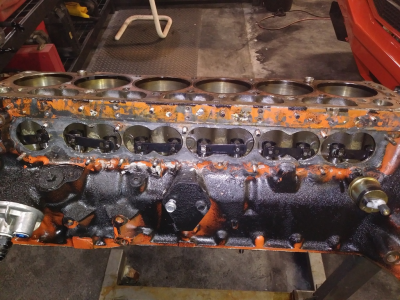

Yes, 300 lifters fit the 200.
It is just a question of getting the tie bars to work.
Someone needs to try it in a 200 block.
Until that time there is no reason to discuss it any further.
This forum speculated for years if a hydraulic roller lifter would fit in a 300 block.
I just simply tried it in a 300 block and low and behold, hydraulic roller lifters can be made to fit in a 300 block.
Too much speculation and not enough action.
