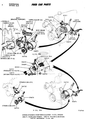

Some part numbers spanned years, some had rapid revisions. All the full part numbers I listed were marked 6 Cyl, 6 Cyl (170,200), or 6 Cyl (250). Almost always the part was listed as just 6 Cyl, rarely was there a (170,200) or (250) designation, and I never saw a (240) designation, though that is covered in the book. If I can, I'll build an image with the part drawings and their designated usage, but that'll take some time.
