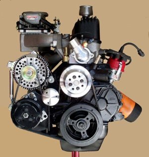

Do you remember the pic here of the serp done ona black 200ci motor?
I recall one view (all we got) of the front dress with that. May have had Mike’s
alloy head (Matt’s is based on it).
I cant find the pic (tech archive?) and try every time some one mentions this conversion.
Thought I’d ask directly as you’ve got some hx here. (May B one of “xtasy’s” or ‘powerband” ?)
They have good sized pic archives...
I suspect this is the one you mean, but it looks like a 250 timing cover, but has the 4.6l damper and the custom h2o pulley I heard about. I think the 4.6l v8 and 250 share a crank snout measurement.

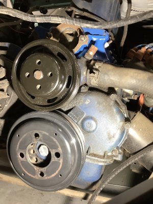

I read about a 200 that used the Taurus balancer and an unobtainable single year Ranger (93?) water pulley, the second pic is my engine pulleys roughly placed and you can see the interference. Planning on slimming the pulleys a bit after the adapter is polished off.

yes, that must B it.
It’s ona thread (of this topic) now. Everything I
could hope for. How old is that pic?
I really dont need to ask but am still curious.
Where is it originally published? Know?
/OR/
Who’s done up this motor? Know?

I’ll pretty sure that’s a Mike W picture, it all looks so perfect with great lighting, etc.

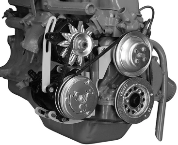

Might be best to use this bracket from Alan Grove Bracket 316r
It uses a Sanden 508 compressor and alternator on top.
jesh!
1) lookid dat down draft tube;
AND
2) the complicated 2 prt bracket & how
the 3rd mount point is off the alternator...
They do the latter today w/the serp. & 5, 6 shives~
I think idler vs tensioner. Usually there’s one or more idlers as well as a tensioner?
Edit: that’s the idler from the pic I posted, that one used an idler for routing, and an adjustable alternator support for tension.
