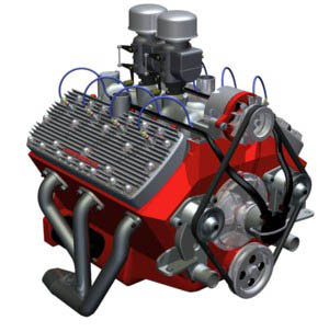

If you want to go to the trouble of swapping in an interesting ford engine, consider this instead:
It never ceases to amaze me what people will shove the 302 into.
But I do agree. THe BMW range of engines are far superior to the 200/250. Better range of upgrades.
