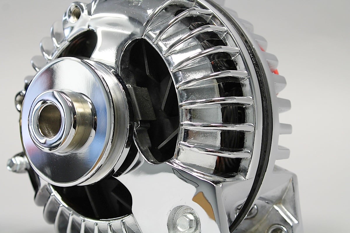

I did some reading in the off time, came across this:
Bud Riser, Technical/Marketing Rep for Tuff Stuff, said, “All Tuff Stuff alternators charge at very low engine RPMs.” Riser stated that it doesn’t take revving the engine to get the alternator to start charging, and that the alternator will put out sufficient amperage at idle.
He said, “There is no need to worry about using an underdrive pulley, or an ignition regulator turn-on with Tuff Stuff units.”
While some of the concerns were valid many years ago, they aren’t a concern with the alternators that both of these companies produce, all of those concerns were taken into consideration to produce one-wire alternators that would perform at idle/low RPM, and not cause concern for modern one-wire alternators.
I can verify, with my Powermaster one wire, it stayed pegged at 14v at idle. Turning on headlights, fan on high, flashers, the needle didn’t flicker. You can read the entire article:
IMO With the simplicity of hook up and superior function, modern one wire alternators are a good upgrade 👍
