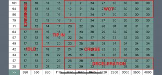

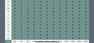

I would ideally like to see what someone has for a timing table showing idle, tip-in, Cruise, and WOT.
I've attached what I've plugged in for the Table Generator, its output as a timing table, and an annotation of the major points of timing per Progression Ignitions 'Tuning Guide' for reference.
The objective at this stage is driveability, with better than the stock performance from the improved carb and spark control/power.
I understand that every engine is different, so the primary discussion here is - all things equal - what is the stock curve?

If you work your way down through this old thread of mine, you'll find a suggested base timing. This should get you started!
Add More initial , reduce the total to 32-34 , slow it down to all in by 2800 , limit vac adv to 8-10 crank degrees , dont let it start till a min of 10- 12 inches , This assumes a pump gas combo with no more than 9.5-1 and 93 octane

With 93 octane you can do more than the above. There are so many variables that with out all the specs you are just guessing.
I have seen many examples of guys running 93 octane & the engine was over octaned.
