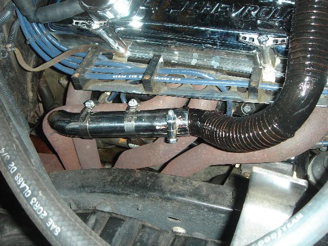

Snorkels will have vacuum motor controlled by the standard ACTS, so when hot air is called for all of the incoming air will be from the passenger side heat stove to the header.
(when Ford used headers like the 5.0 Mustang from 84.5 onwards, and the 90's 2.3/2.5 Ranger trucks, they used a clipped on pipe to the header.When updated, use this
or Stormin'Norman's hot air plenumb
Similar to the 1968-69 Firebird Exhaust Manifold Heat Shield
When cold air is called for, the flapper will open fully the snorkes will pull cold air from the radiator support (Big Foxes like the 80-82 Cougar xr7'S, Tbirds, F trucks), or about the battery area (all other Fox bodies, 75-80 Granadas, Monarchs, Versaillies)
