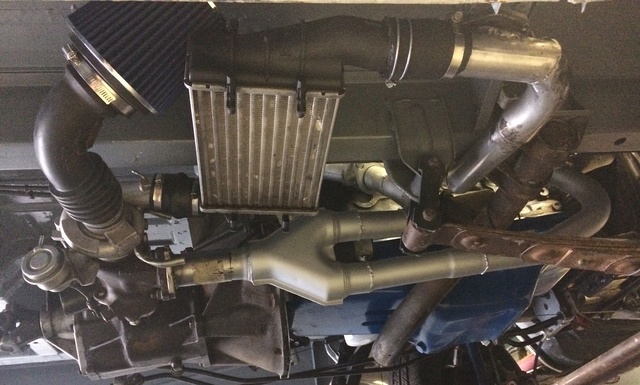

Never satisfied with leaving well enough alone, I'm in the process of building a EFI turbo setup for my '65 Econoline pickup using the original 240ci engine. I've built and installed a MegaSquirt EFI system controlling a Chevy throttle body injection (TBI) setup. The turbo is hanging back by the transmission and hooks up to a custom exhaust using two rear EFI manifolds from a 90s F150 4.9. It's still a work in progress, but coming along nicely.
I'm still finishing up body work while slowly putting together the turbo setup, and still a few weeks away (at least) from getting it driveable. It's been an interesting challenge so far. I'm hopeful that 7-8 pounds of boost from the little Subaru WRX turbo will really wake up the 240 -- although it already ran fine on the old single barrel carb.
The turbo hangs back by the transmission and is supported by a fixed hanger attached to the transmission and a flexible hanger bolted to the bed floor. The tiny intercooler is horizontal to the air flow under the truck, and I'm not sure how much cooling it will provide, but probably better than nothing.
Right now the turbo is drawing air through a cone filter above the intercooler next to the bed floor. I'm still debating whether I should route a pipe to the front of the truck or just leave it there.

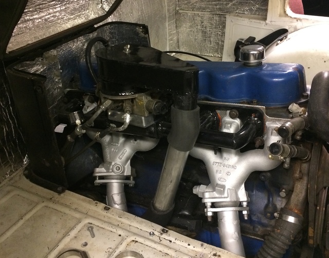

The intake pipe is routed between the headers. I plan to wrap the headers to help reduce heat in the engine compartment and also keep the intake air a little cooler.
I build a custom intake plenum to direct air into the TBI. It easily fits inside the engine compartment. My next step is to finish plumbing water and oil to the turbo and finally hook up the exhaust.

Is there room to add an electric fan to the intercooler?
You're the second person to suggest a fan. There's plenty of room and I already have to run power to the scavenger pump in the same general area so it would be fairly easy to do. Still, my initial thought is to fashion a scoop to direct air up thru the IC. My only concern would be how much road crap it would collect.
The fan would only be "ON" when boost was above a certain low level.
Megasquirt does provide the option to control a fan based on boost level, so definitely something to consider...
I mounted the heat exchanger for my water-to-air intercooler under the body of my Tahoe. I had 2 electric fans mounted underneath it that ran continuously. I didn't have any temp sensors mounted to see how well it was cooling the water (green antifreeze), but I had a general feeling that it just worked "ok". I have since moved the heat exchanger to my front bumper. One of the fans only lasted 1 year, but I daily drive mine, which includes snowy roads with salt on them, so that didn't help. I'm guessing in Oklahoma you'd be ok, but I just thought I'd share my experience. Neat project.
I have been watching your build for a while. Thanks for sharing. Do you plan on using the bed of you truck as a bed of a truck because it looks like a great place to put a turbo,inter cooler, and oil return lines.
