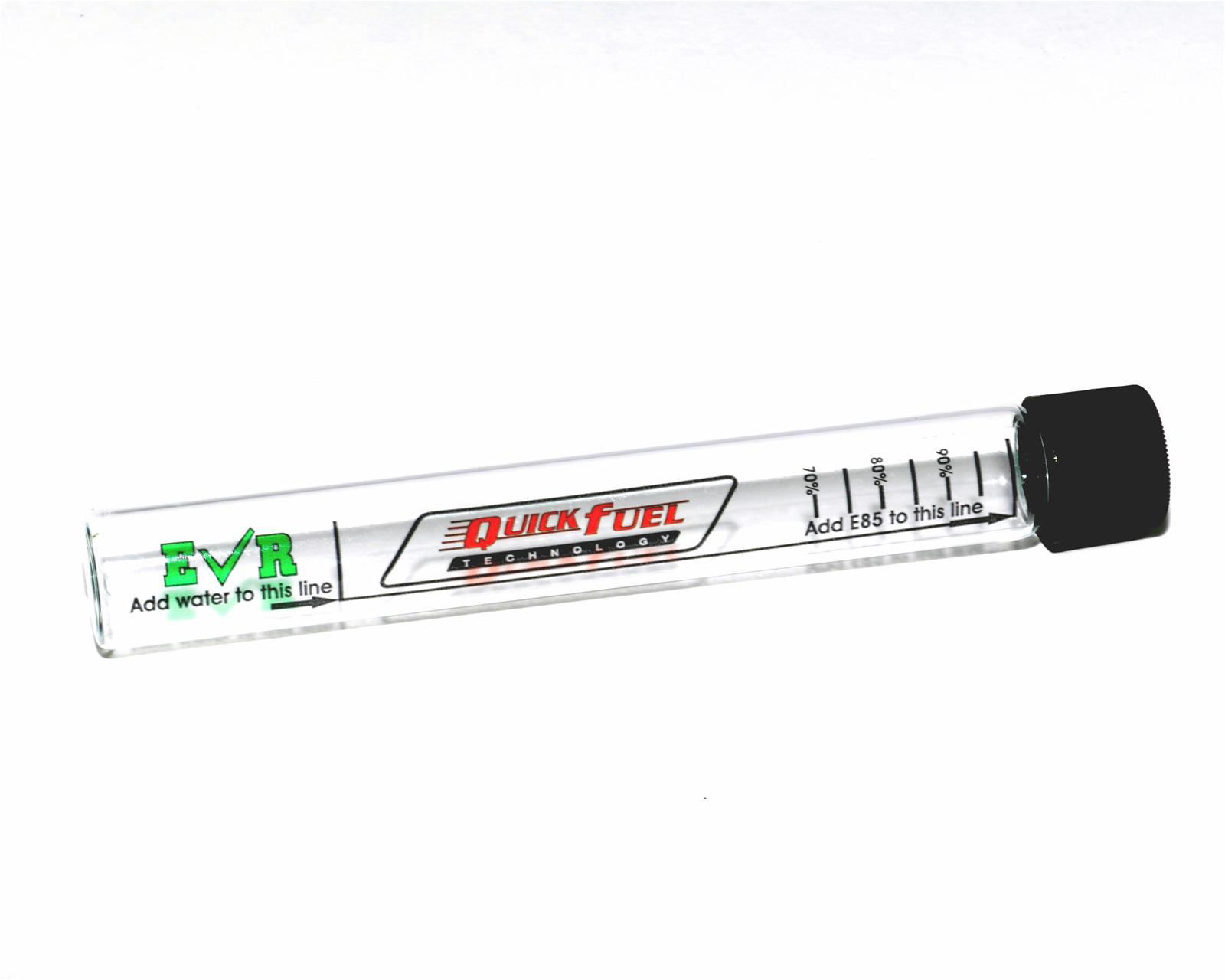

here's what we use.
Fuels at ur pump are mixed totally different season and geo location from one to nother.
We want it right @ the track...
Once U get the puter under the hood there's more to consider too~
Chad, i just drained the tank of fuel from 4-21. Just put in Sunoco 91 octane to get it 1/2 full. Will see what happens. I will install a phenolic spacer in place of the aluminum one now.
Bill, its U, just seen over a falcon FB site! U know what U pour? Ever used one of those pipettes I mention above? i think of VL as going w/humidity when I lived on the Chessy (0 -10 y/o ). Since up here (the NE 1960 - efi) never had it again...
do U care? At 9.1/9.3 CR, "No". My daily is @ the pump. What U suggest, Marco is when it matters. It's is basically VP Racing (differnt metal 5gal cans sold nation wide for when it matters). That's 80% of what we mix for/from for the track, yeah, we care there @ 10/12 CR...

But here again, its the same. What is it actually? U don't know till tested: post 8.
