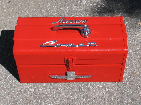

here is my latest modification to my Comet....
http://www.angelfire.com/falcon/comet0/toolbox.html
Very cool box Marc. I saw it on the Comet-List. Does that handle seem really secure? I suppose it depends how much weight you put in it. That's a really nice box man. Good work!
