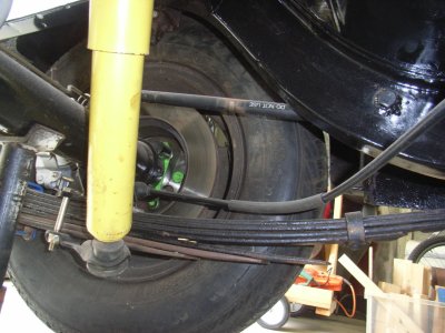

'62 Ranchero, working on correcting the rear pinion angle for the swapped in 8" from a Maverick. Cutting the angle correction into 2" drop blocks, 4 degree correction, running sedan arched springs.
Made some traction/slapper bars last week welded into the lower spring plates, correct length for the snubbers to hit at the front spring eyes, not back on the main leaf arch.
You need these traction aids, better than slapper bars. Works under brakes as well as forward, cant drag on the ground.RIMG0254.JPG
