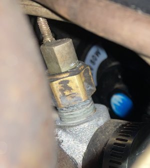

This is the sender that was in the back of the head. I moved it to the thermostat housing so the dash will still work but I don’t have it hooked up yet. This one will not run the new gauge

Hi, that is not an original Ford sender. It does not look like a replacement either. Good luck
I think it is, my 170 has the smaller sensor, this looks like the bigger one's on early 200's, but usually in the back of the head from factory instead of the thermostat housing.
