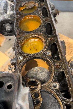

Question from a beginner (be gentle haha). I have a 1961 Falcon 144 engine that I got for free off craigslist.
Posted briefly last year about beginning to tear it down here.
Well, as you can see from this photo, once i got the head off, it was in pretty rough shape inside. Standing water, wouldn't rotate, and several pistons were rusted in place:

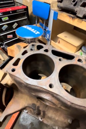

I've made serious progress since then and have been able to get 5 of the pistons out, and the cylinder walls actually look pretty darn clean.

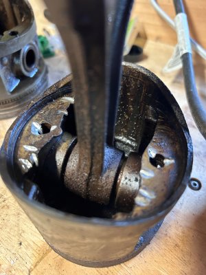

Well my question is about what I did to the pistons while getting them out. Again, being a beginner, I did some probably unnecessary damage to their undersides hitting them with a piece of metal to dislodge them:
Probably worst example:
The top and sides look great and took no noticeable damage (didn't fall on floor or anything), but how serious is the damage to the underside?
Obviously if this was a high performance engine that I paid for work on, I'd be pissed, but my question is more: "if I debur everything, will it run without blowing up?"

Cost wise, you'd probably be better off just finding another engine. Facebook marketplace or Craigslist. 144,170, and 200 will bolt right in. Easy to find complete running engine and trans for $200-$300.
I'd say those brute-force removed pistons are toast.

Even if the pistons were in perfect condition you probably couldn't reuse them. The cylinder bores are so rusty that they will probably need a lot of boring to clean up, if that's even possible. The old pistons would then be a pretty loose fit...

I think until I figure out what to do I'll just keep stripping everything. Get the final stuck piston out, clean everything up, see how bad the cylinders are, etc..

While you have successfully removed the pistons from the bores if you try to reuse the pistons the next chore will be getting the old rings off without damaging the ring grooves, getting the pistons out will seem like a walk in the park compared to this chore. Since this is a shoestring deal you could try looking at pistons from other engines with a near 3.5 " bore and see if you can find some that have a similar CH and wristpin size. For example Ford 221 V8's and Buick Olds 215 V8's also have a 3.5" bore but I don't know if their CH and wristpin sizes are close. Another thing you can do is check evil bay some vendors on there have old stock pistons for older engines that are sometimes very reasonably priced, its usually from a buyout of a defunct parts supplier or repair shop.But before you drop anything on pistons make sure the block is crack free with water in there it could have frozen.
