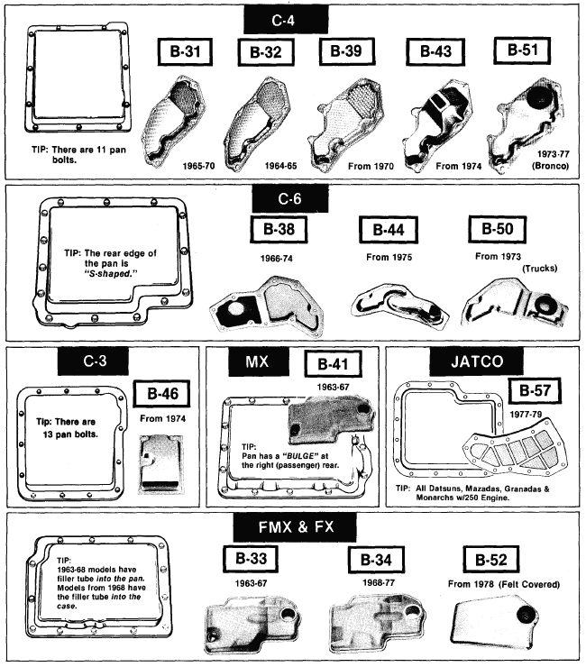

I think that the C5 has either a deeper pan or a hump in the pan. The C3 is easy to spot because the modulator is on the passenger side of the transmission instead of at the rear.
Maybe this will help:

Thanks for the good diagram.

C4 and C5 use the same pan gasket, but different pans and filters.
Two different C5 pans:
1) Shallow with a "Bump" on the bottom
2) Deep pan
Bring the old filter with you to the parts store so you can get the right one.
Oh, good, the diagram that MustangSix re-appeared. It was gone for awhile. I was worried Id have a problem ID ing it.
Thanks, MSix, cause I plan to pull the pan this weekend. Then I can ID the tranny.
By the way, which is the C5 on the chart (?), because theres other numbers...or should I look at the C4 pan sizes and pan forms to id it?

By the way, which is the C5 on the chart (?), because theres other numbers...or should I look at the C4 pan sizes and pan forms to id it??
The C5 didn't come out until 1982, the chart was printed before that.
Use the pan gasket to get close to what you have.
"RIGHT CLICK" on that chart above and save it to "My pictures" in your computer, then you will have it forever.
