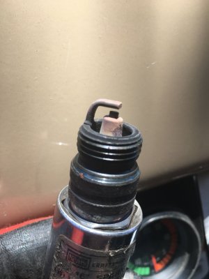

On the latest test drive w/new jets installed, the spark plugs look like this:
I pulled #1, 2, and 4 and they all looked very similar. This is after driving at 40-45 mph and turning the key off and pushing the clutch in, coasting off the road. I was able to pull the plugs from the driver’s seat even with a seat belt on!
Any thoughts on the plugs? It seems to run well. The engine is only happy with the idle at around 12.5.
Plug looks good in the photo 😎
With the idle around 12.5, let it idle for 15-20 minutes and check the plugs again. I would say it it is happy there, leave it and see if any negative issues arise 👍.
Assuming all other aspects are correct- timing mostly
