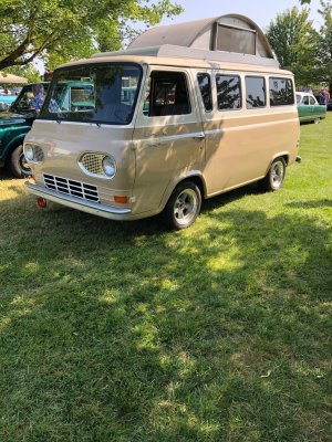

Fired up the engine this afternoon; it ran well while still on the jackstands. I couldn’t really prove it, but it just seems happier. We have winter weather forecast for the next week straight so test drives will have to wait. Stoked to see how much better the engine performs on the road.
This is what I’m working on. If you see us tooling around, give a wave.

That’s a really nice ride! About 20 years ago, my brother in law had one of those in 2-tone blue without the pop-top. It was a great and unique van. The steering was pretty light considering it wasn’t power assisted. I liked it. You’ll have to report back when you’ve had a chance to do some driving. It seems to be coming along really nicely.
We got our first dump of snow up here over the last 4 or 5 days with another big dump last night. The rest of the week is forecasted to be below freezing but clear until the weekend when we’ve got more snow coming. All in all, it’s still been a pretty mild winter.
Nice ride! Did you make the camper conversion? I had a high-school buddy with an old Econoline van, had many good times riding around in that. I wish I'd been along when he got pulled over for smuggling machine guns though. Full-on felony stop with multiple police cars and even a few FBI agents. What a rush! But his van only vaguely matched the description of the guys they were after. They were so apologetic when they saw their mistake they didn't even confiscate the only contraband they found, a bag of weed and open bottle of tequila.
Thanks guys, the camper top was part of an aftermarket conversion done back in the day- sort of an OG "vanlife" scene. All of the big three automakers's vans received this treatment with pop-tops of some sort and camper accoutrements. The Fords were badged "Travelwagons" which is what I have. The camper stuff was gone when I bought it, with only the top and the hammock remaining of the original camper package.
I think it is a hoot to drive and now that it runs even better, I'm really looking forward to "traveling" it around.

It seems almost every time I drive the van somewhere, someone will accost me and has a story about how they owned one, or their family had one or they used one at a job or knew someone that had one. People really dig the van- I don't know what it is, but I understand.

By the way, every time this page loads and I see the photo of your van at the top, it makes me smile. What an awesome vehicle.
Thank you for that! It seems to have that effect on many people, including me. I've always been fascinated by these old vans.
