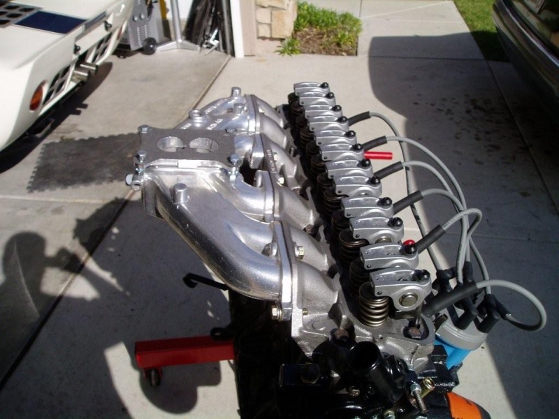

x - do you know what these are?
and these

Post #22 by JackFish » Fri Dec 25, 2015 6:12 pm
I got the photos off the Classic Inlines website.
I think the top photo is a guy that was on here for a while from down under somewhere.

Post #24 by xctasy » Sat Dec 26, 2015 2:41 am
JackFish wrote:x - do you know what these are?
and these
MustangGeezer and CobraSix used the white box supplier to produce Classic Inlines Roller Tipped 1.6 Rockers, a US made version based on the ST2014 Yella Terra 5/16" rocker hard dimensions, as per thinman56 and others here. Might have been made by Scorpion, judging by the anadised color. Harland Sharpe was orange, BRC (Brooks Racing Components) roller rockers were like Crane or Erson , I think.
These are Street Terra ST2014's
http://store.yellaterra.com.au/ford-inl ... ef-st2014/

The blue ones are RAS, rocker arm specialty's ,not sure if still in business. Sold as 1.6.
