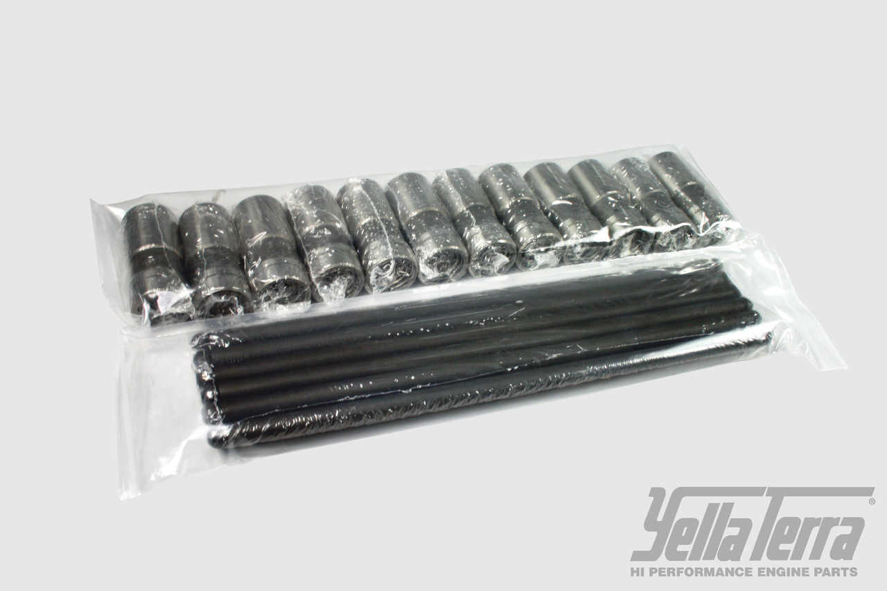

A combination of light oil weight, White Box HT 2083 lifters that you can't be sure arn't defective, and the normal issues which also afflict the similar Ford FE and Cleveland style engines is likely to be your problem.
Go to HT 900 R lifters, and recheck your pushrods an adjusters at full lift. If the ball ends don't wor together, get another kind of pushrod, or have them die ground and linished to clear the rcker arms.
Check with Bob the Builder on what lifters he used in his 62 250 pickup Ranchero.
50 bucks outa do a change for you. I'm baking on lifter collapse.

yellow terra rocker arm install tips, Post #1 by rbohm » Sun Aug 24, 2014 5:09 pm
When you install the yella-terra rocker arms you starve the distributor gear & camshaft gear of very needed lubrication.
To fix that condition the second & third lifters are on either side of the oil hole above the gears.
You can cut a .025" x .025" groove in those two lifters and that will flood the area with the necessary lubrication to prevent scoring of the gears.

No one can track and trace white box goods. I'm pretty sure that's the issue. Lifters can drop oil pressure just like that.

Just to recap on what we do down here:
The HT 900 are all oil through 0.874 thou pushrod lifters.
I guess you don't want the roller rockers that come with that package.
Initally the HT 900R's or VL65R were Cleveland 2v and 4v hydraulic lifters only for cast in rocker or posi locked studs. The oil priority is only through a hollow pushrod.
In 1984, Yella Terra designed some extruded Roller rockers for the non cross flow 2V 250 and log heads, and was able to use the common FE and Cleveland rocker arm conversions with a special rocker shaft on a posi locked stud conversion.
Then, later on for our log and 2v 250 sixes, they made non roller rocker adjustables to reduce cost. As Chevrolet has found with the 1996 onwardsLS1's, roller rockers aren't needed on engines that only do 6600 rpm tops, with less than 300 pounds peak of the seat loads.
So this is the kit, but its 680 bucks Australian, and I guess its too Dollars X x X "cOST-A-LOT"
But it is a good kit. wsa111 has found that thiskit restricts blead back to the distributor shaft, and has issues, so that's why he suggests slot machining the lifters to bath the cam gear and distributor. In fact, there is an option of even drilling the distributor shaft too.
Anyway, the kit has some restrictions, but it uses the HT 900 lifter, GM Holden 186/XU1 202 cubic inch pushrods, and the common roller rocker shaft stud, without the roller tip rockers, but with the roller trunion at the stud. It has two meaty stud girdles to stop the whole shooting match from moving too.
You use a 186S or XU1 Torana pushrod which are common and easy to get, but then you have to run a the common Street Terra non roller tip 1.65:1 Extruded rocker like all non shaft mounted Fords. And its mini rocker shaft.
The lifter is found on millons of Fords since 1962...
x-flows from 1976 to 1992
1965 on 240/300's,
1969.5 to 1983 335 small and midland blocks,
1983 -1995 HSC 2300 and HSO 2500 in line fours,
1968 to 1997 385 Big blocks
Boss 302 Windsor and WCP aftermrket SVO and FRP "Clevo" blocks
And 1962 to 2002 Windsor SBF'S
And Yella Terra roller rocker conversion 200 and 250's above
