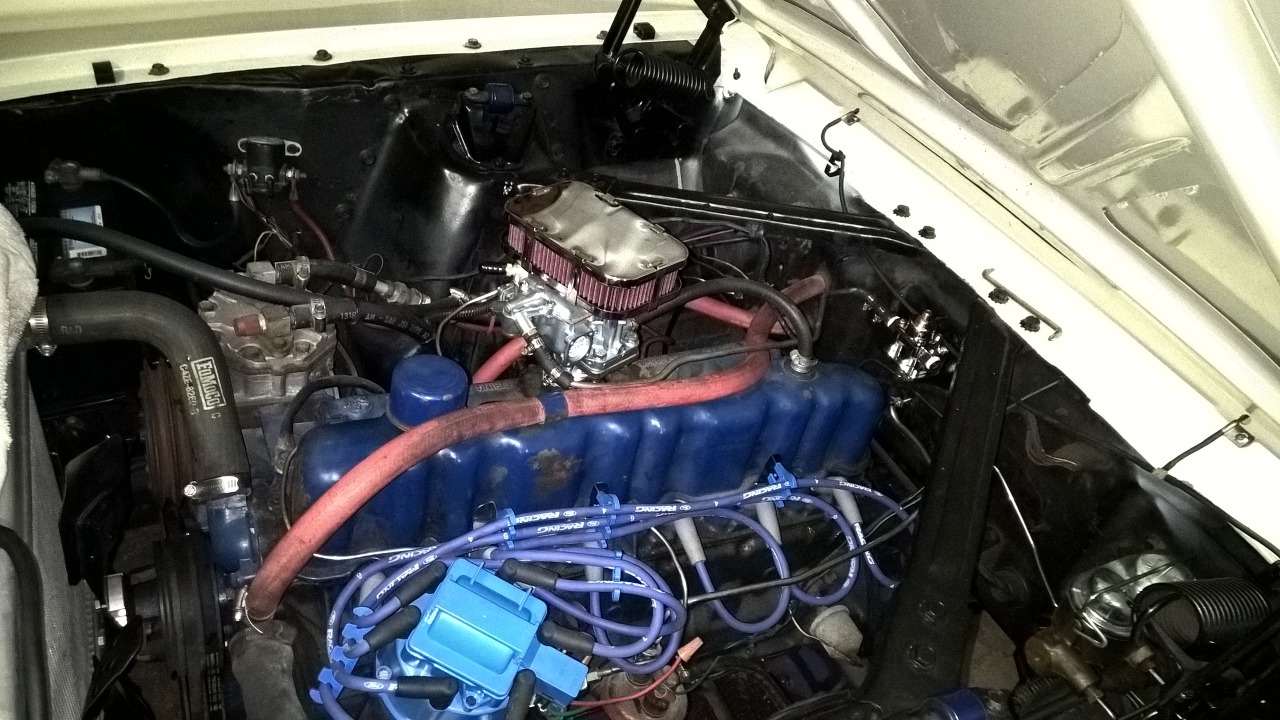

images
Option 1
Powerbands.
1. Fairmont/Maverick over rocker cover to drivers side cable
2. Langdon adaptor
3. Holley Weber 5200 from 1974 Mercury Capr 2600
http://www.jalopyjournal.com/forum/thre ... ci.447791/
Option 2
1.'61 linkage (note very similar to the '65)
2. The adaptor: Ariberts special adaptor, a Langdon kind of adaptor, but with a spacial casting he made. He has offered to hand some of the info to another party if they wish to, but this is a specfic 32/36 adaptor
viewtopic.php?f=10&t=56967
IMHO, with the 32/36 carb, the Classic Inline adaptor won't help you any...
3. 32-36DGV
from http://66mustang.tumblr.com/
