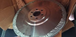

A picture is worth a thousand words and all that ….:)
This is what i got. The sharpy mark is how i am to install the clutch on it.

Post #6 by drag-200stang » Fri Jun 07, 2019 9:15 am
Looks good Star.
Can you show us the back side ?
I have not seen a 200 flywheel come apart, the billet it is a smart thing to do.
I have typed about this before,I had two oem strong tuff man pressure plates come apart...No part of the pp or the bell housing found larger than 1'', blew off block and trans mounts, cut off the starter nose, severed one header tube, put cuts in floor...this happened at the 7000 range...No good rev limiters at that time.

I think that materials are better today, and with a hyd. cam it will not rev high enough to be a problem ... Rev limiters are cheap enough no reason not to have the added safety.
I think that you will be fine.
