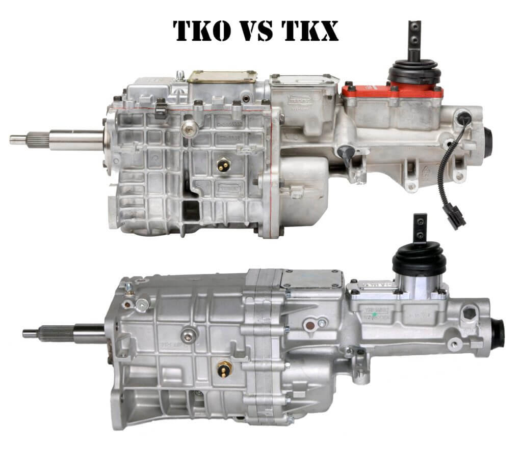

Check out the TKX transmission. It has a torque rating of 600 ft.lb., significantly higher than a T-5.
The TKX is also smaller than the TKO, so it may fit in your application.
That transmission is nice. Its even got a 10 spline. I wouldn't mind that trans too much. Good eye man. Its just money hahaha
