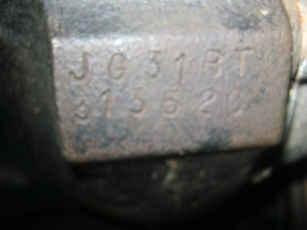

The block reads JG23FA 20290C

Block should have at leat 84DA6015AA cast on it to be an 1985 engine. With a neoprene main crank seal.
There are about 9 potential head castings and the chambers were practically machined to suit application; later unleaded ones have provision for a knock sensor, larger valves, and high swirl chambers.
If there's no casting no external casting stamps or raised lettering between 1 and 2 ports, its the first type, the XD Oct 1980 to March 1982
Inside, with the rocker cover off, there are always some kind of generic casting of the form HFx on the flat area above no.5 cylinder.

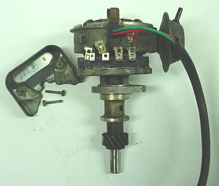

Addo answered it Thu Apr 28, 2005

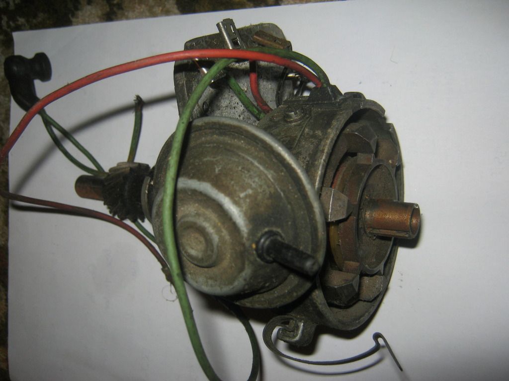

addo wrote:For the questions we get, and the curious, here is one.
Image Image
Image Image
Nothing to be afraid of! :)
Adam.
viewtopic.php?p=174861
Bosch Type 61. Used on 245/265/318/340/360 Mopar, 173/202/253/308 GM Holden and Ford 302/351 v8's and 200/250 sixes from the mid 70's to to early 80's.
Its the solid state vac advance system on the far right.
Wires are green and red on those for sure.
9-230-064-705 came out of a 3.3 or 4.1 auto falcon or TF Cortina high comp engine.
9-230-064-710 manual 3.3
9-230-064-711 4.1 auto
9-230-064-716 came out of a XE 4.1 auto

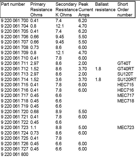

Specs are You need a coil with Primary Resistance of 0.45 Ohms, Secondary Resistance of 6.6 K Ohms.

Distributor test:

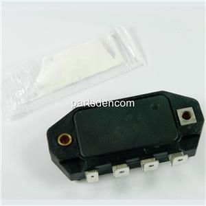

Connect a volt meter & an LED test light to the blue/white wire on the ignition module.
Cranking over the engine should get a pulse through the volt meter and the LED light also pulsing. Distributor test is OK if it does so

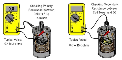

Coil test:
Using an ohm meter check the primary terminals, should read 0.45 K Ohms. Check secondary terminals, reads: 6.6 K Ohms
Put timing light on lead running from coil to distributor, you should get strobe. If nothing, no strobe, then a reluctor problem. Should get same result when tested on all spark plugs.
Check with Volt meter on both terminals. Voltage should fluctuate and LED pulse.

I've updated this. The GT40T i'd suggested isn't common, and might have too much primary resitance, so it wouldn't work well.
Can you confirm the number on the distributor? I assume Automatic, 4.1 1985 is 711 or 716, which one is it?
One is 2.97 ohms, the other 0.41. I'd be certain that the ignition is 716, the common low sub 1 ohm kind.
If you could confirm Ken.
You just need to track down a replacement non ballast resitance high out put ignition coil with below 1 ohm primary resistance.
Duraspark II coils are not what you want.
The range is due to the application and settings Ford had on each engine. The coils themselves from October 1980 to late 1985 were the same unless they were EFI.
For exampe, the California spec 1977 to 1979 302 Monarch or Granada carries the common old D7AZ-12029-A Ignition Coil (Motorcraft DG-316), is 0.70Ω primary resistance, 7,750Ω secondary resistance and no ballast resistance (the coil operated at full battery voltage, but it has the ballast to dissipate a few hundred watts in certain situations to saturate the coil for starting).
You don't need a ballast resistor
Generally, any non ballast coil will work fine.
The specs for primary and secondary are normally like this, which is in the range of the Bosch 705 to 716 series coils.
Most coils should read between 0.4 and 2 ohms primary. Zero resistance would indicate a shorted coil while a high resistance reading would indicate an open coil.
Secondary resistance is measured between the positive (+) terminal and high voltage output terminal. Newer coils with segmented core construction typically read 6,000 to 8,000 ohms, while others can may read as high as 15,000 ohms
So any non ballast coil with below 1 ohm primary resistance should be a good start.

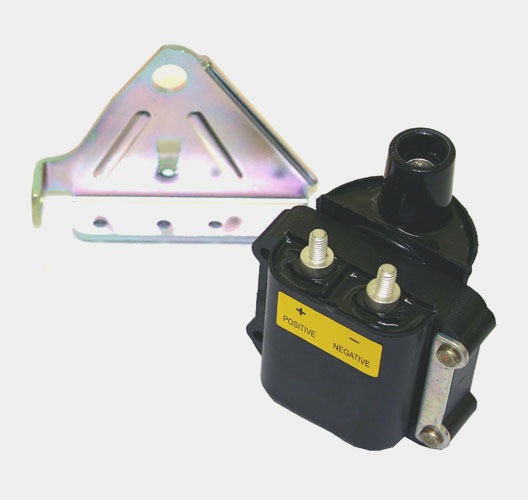

The Ford TFI style of "E-core" coil primary and secondary ohm specs of 0.44 to 0.68 ohms and 5.5 to 4.8 K ohms, depending on the date it was made and the maker.
Less than 1 ohm coils are electronic controlled to hack the current. A non oil filled replacment is the S10 remote HEI coil (These coils are found on HEI engines with small caps [except inline 6's with large cap HEI with coil post], late 80's to 90's 350's, 4.3's and 2.5's mainly GMC and Chev trucks and vans. 2000 and up coils are usually 0.2 ohm). These are like the Chrysler Australia /Ford Australia/Mitsubishi Australia and GM Holden Australia coil's.
The remote coil has two connectors. The gray connector is the 12V coil power supply, the large pink wire goes to ignition "on" power for the distributor, the white wire can be hooked to a tachometer. The black connector has the smaller pink and white wires which goes to the two wire connector on the ignition module on the distributor. From black connector small pink to "B" and white to "C" on module.

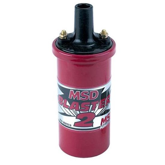

This is what I got MSD Blaster2 PN 8202 primary .7 ohms secondary 4.5 ohms
FALCONS AND RANCHERO'S FOREVER
Posts: 7059
Re: X-flow distrubitor
Post #11 by xctasy » Wed Oct 05, 2016 6:25 pm
papawfalcon wrote:This is what I got MSD Blaster2 PN 8202 primary .7 ohms secondary 4.5 ohms
Nice choice!
Sorry about all the tooing and froing, but that will get you in ball park with a nice fat spark. Well done.

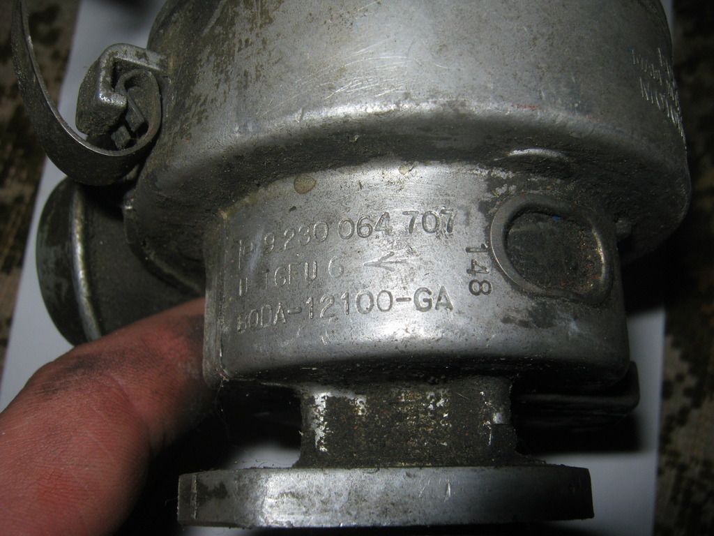

Post #13 by xctasy » Wed Oct 19, 2016 3:35 am
papawfalcon wrote:CODE#? on the distrubitor?
Yeah, behind the plastic cover!

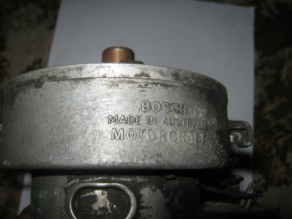

Bosch made the distributor with a Motorcraft name, and Ford called it Duraspark, but its actually a 61 Bosch points distributor with new 64 part number, and 61 state spark amplifyer. The suffix 9-230-064 707 and 9-230-061 707 should match
9-230-064-707 XE 4.1 auto
One of my many engines an XE 4.1 auto
with HF2 head, and its got "9-230-064-707" stamped on the distributor.
I'll post photos soon.
