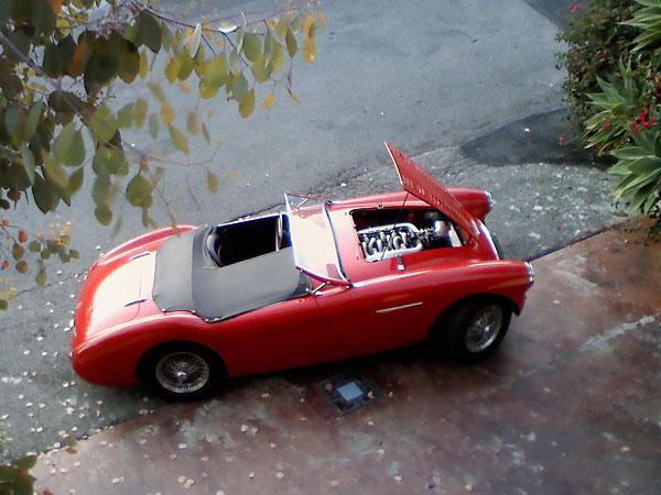

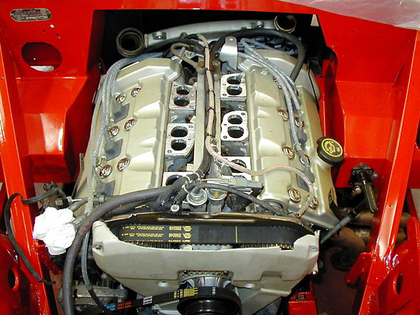

If you want to go Ford don't rule out the V6's. Not the 90-degree 3.8, but the 3.0 DOHC duratec engines found in various Taurus and Sable models.
Sweet sounding, high revving engines. Perfect for a lightweight Fox-body.
And the four cylinder engines aren't bad either. The later Ranger DOHC 2.3 and 2.5 are an easy 200hp and the earlier 2.0 Zetec is pretty nice too. Very lightweight. This is the one I just finished putting into my son's MGB:
The rest of the build thread is at http://www.focusfanatics.com/forum/showthread.php?t=302371

Of all the designs that spawned the Duratec 4's and V6's, the specifically Yamaha designed SHO Taurus designed V6 is the most compact and smartest quad cam engine ever. Its the heir to the Aston Martin V12, the SHO V8, the Volvo S80 V8, and the legion of Yamaha v6 and v8 jet boat engines.
Fox parts raiders can take a leaf from mgman75's book, grab an old lowly Fox like a 1993 2.3 Mustang and plumb in the SHO, an Areostar 4-speed auto, and turn it into this
into this
Ditch the EFI, and run six or eight motorbike carbs, depending on if its an SHO6 or 8. The frame is basically Aussie Ford Cortina, and they've been using rat rod chassis horn mounted frames since 1977 for there TE and TF's, and those kind of engine mounts are dead easy to fit up.
